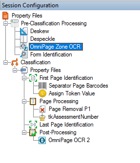

What i want to do is have a single sheet at the front of the entire Batch with and assessment number on it that's picked up by Zone OCR and set as a Token Value, this sheet is only scanned once and then deleted.
How can i get this one page scanned once then deleted and keep the Zone OCR token?

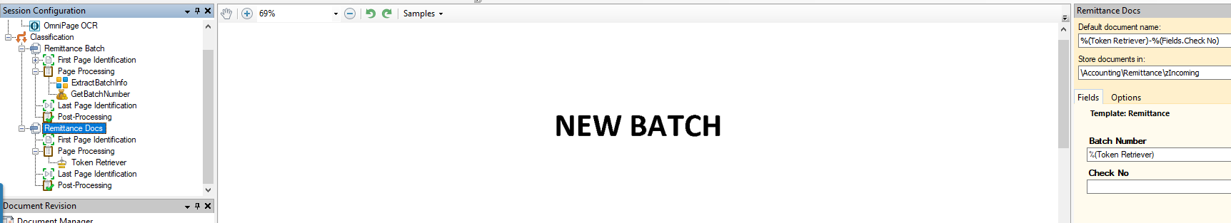

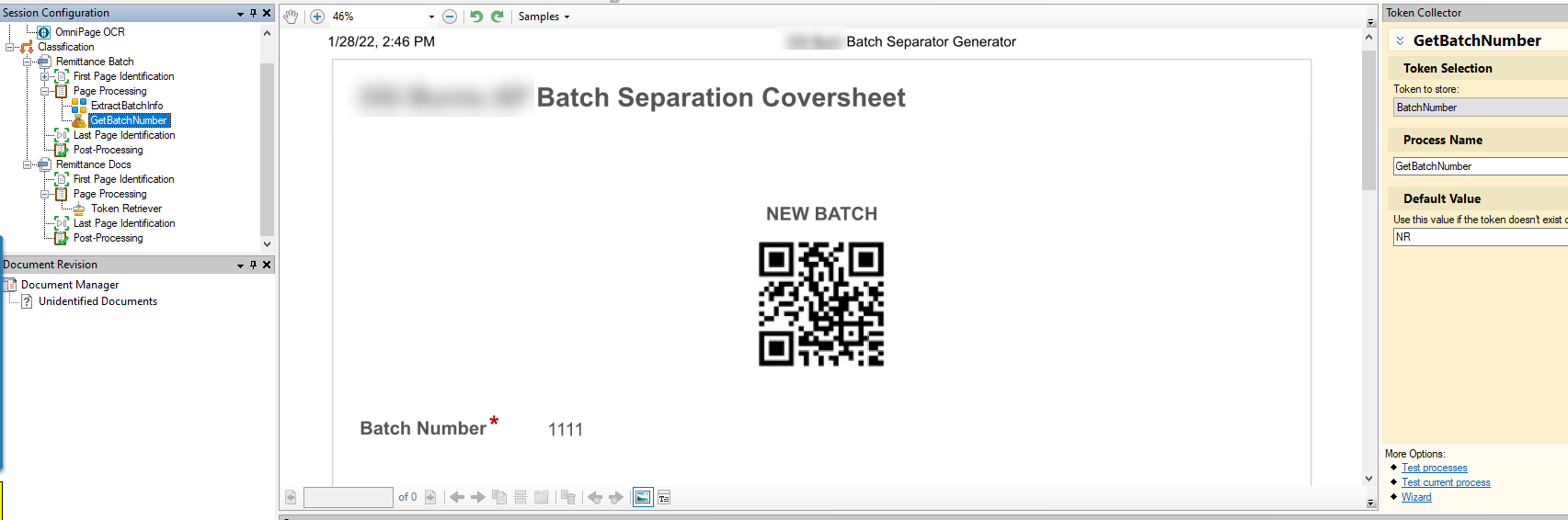

Here are some screenshot's to provide some clarity on what Jacob provided above:

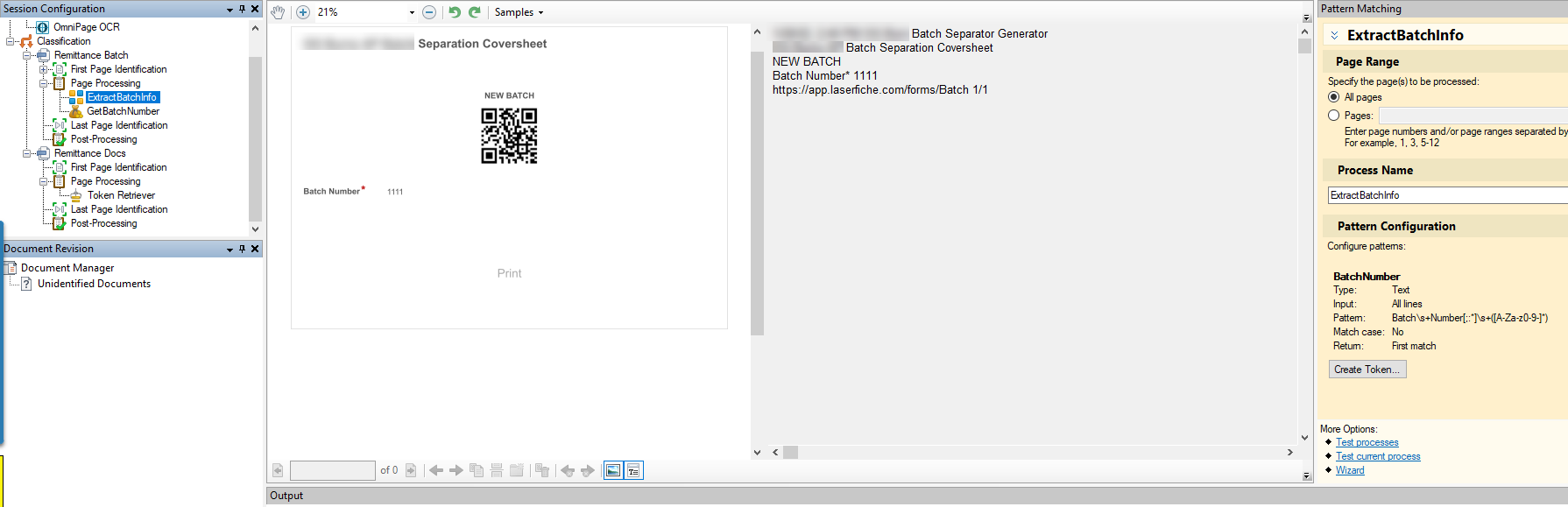

A QF Session with 2 Document classes using a batch seperator page (Created using LF Forms)  and Pattern Matching to extract the batch number then using the token retriever to store the info for the next document class.

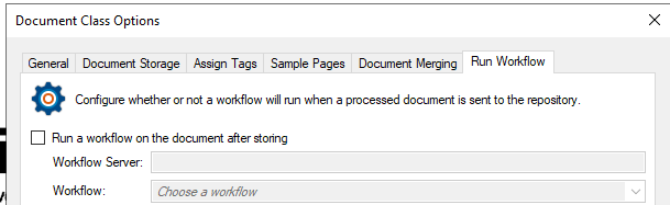

Note: The storage location - Using a PA (Process automation) workflow to delete the batch coversheets once store to the repository
