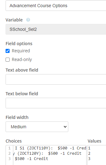

I have a dropdown field SSchool_Sel2 and assigned the values to those dropdowns which when selected will display the msg "Maximum selection count reached"

When the user logins to the form based on their id the fields are auto populated based on a lookup rule. When the SSchool_Sel2 dropdown field is clicked the user is given the choices of selecting certain courses. For the 3 courses listed in the dropdown value (above screen shot) the display msg should be visible. If the user selects a course not listed in the above screen shot the display msg should be hidden.

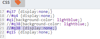

I have the html field hidden in the CSS section of the javascript.

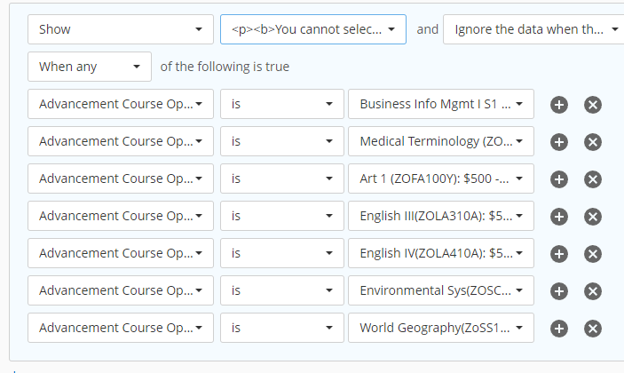

I tried using field rules to show the html msg if the 3 drop down values are selected (as shown in the screen shot) It's not working as expected.

You could show/hide objects with your own script but that is what field rules are there for. I mean your field rule configuration is correct, so this is less of a question and more of a system issue. If you say to show a message when any of the following is true, and it doesn't show when one of those statements is true, something is wrong.
I would contact your VAR to have them look at it as a potential issue.

  1. You said "I have the html field hidden in the CSS section of the javascript."  If you have CSS code that is hiding the field, then Field Rules are not going to be able to unhide it.  You're effectively hiding it twice (with CSS and with Field rules) or hiding it once (with CSS).

I see your point.
I commented out the display none on #q38 (which is the html field). I tested it and it still does not show the msg for the dropdowns which is marked in the field rule to show the html msg.

I’m not at a computer to test, but unless I’m mistaken, // does not mean comment in CSS the way it does in Javascript.  Comments in CSS are via /* to start and then */ to end.

This is the field rule

Yes you are right. When i used /* to comment it works.
So now if i comment out #q38 the msg shows as default when the form loads. It should not show unless the drop down selection is made. Any suggestions?
