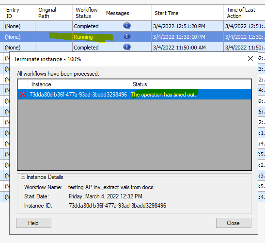

The block of regex I need is 965 characters. It has grown to that size and this last iteration is forcing the workflow instance to freeze and NOT terminate for at least 10 minutes. It will time out several times and then eventually terminate. The only changes made have been to the complexity of the regex in pattern matching.
I have attempted to use this technique and that also will not terminate the workflow.

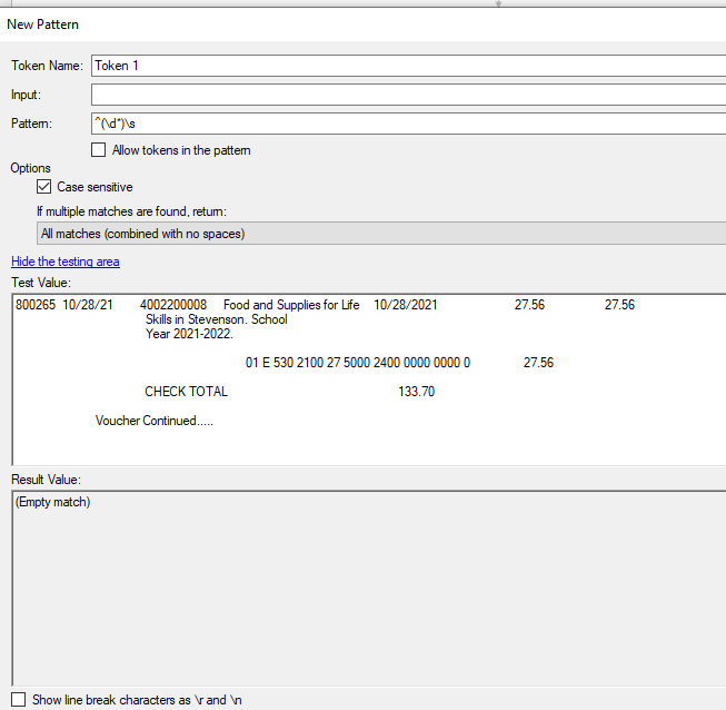

^(\d*)\s
That should get you just the invoice numbers.

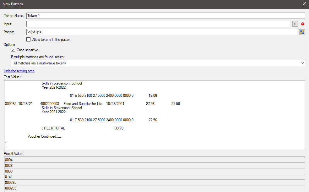

Looks like Laserfiche has trouble with the ^ character. \n(\d+)\s seems to work.

^ is the beginning of the input, which in this case would be the top of the text file.
