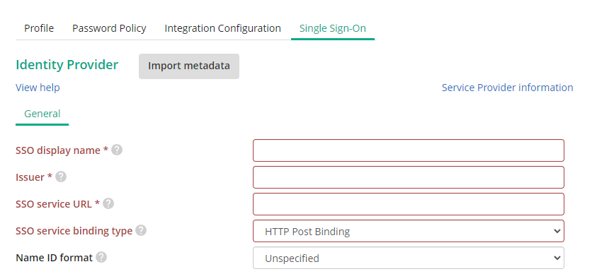

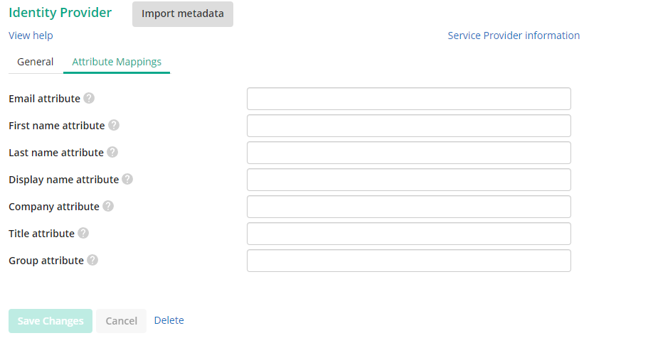

I am setting up Single Sign-On in cloud, however this config webpage is missing the Endpoint field, the Certificates upload, and the Type drop down list. As well as having an additional required field that is not mentioned in the documentation.

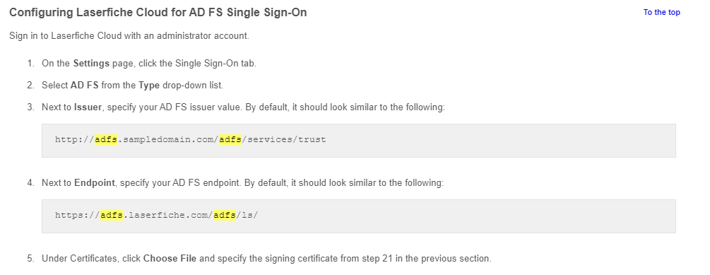

Instructions are as follows
Source: https://doc.laserfiche.com/laserfiche.documentation/en-us/Default.htm#sso.htm?Highlight=ADFS
Without Endpoint, Certificates, and Type fields we can not complete these directions.
Finally, the documentation makes no mention of what to enter in the required field SSO service URL.

The documentation is a little outdated.
  1. SSO Service URL is indeed the updated label for Endpoint.
  2. Type has been removed
  3. Once you save the initial SSO configuration, you'll be able to upload the certificates on the screen below the save/cancel buttons
replied on March 3, 2022
Thank you that worked. Could have never guessed.

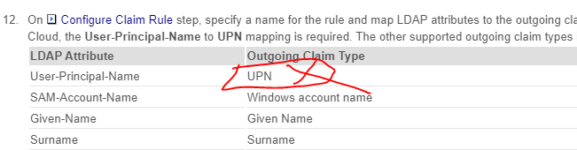

replied on March 8, 2022 • Show version history
Is it possible this setting is incorrect as well?
Should it be Name ID instead of UPN?
This was reported as an issue by IT
Hi Chad,
That was a requirement for LF Cloud's original ADFS implementation. The requirement for UPN is no longer a requirement. You can set any claim you like as long as the correct attribute is also specified in SSO configuration for LF Cloud.

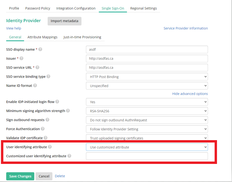

Where is the SSO configuration for LF Cloud?
Is that this page? I don't see User-Principal-Name here so maybe this is the wrong area. We configured the claims on the ADFS server, there is no mention of configuring anything in Cloud outside of the article below
https://doc.laserfiche.com/laserfiche.documentation/en-us/Default.htm#ConfiguringSSO.htm%3FTocPath%3DAccount%2520Administration%7CConfiguring%2520Single%2520Sign-On%2520in%2520Laserfiche%2520Cloud%2520%7C_____0
In the Identity Provider configuration screen, there is a field called User identifying attribute. By default it's set to NameID, so you should probably leave it as is if you are intending to use NameID. However, if for any reason, NameID isn't sufficient, then you can set User Identifying attribute to 'Use customized attriute'
I see, there was no mention of any of these advanced fields in the documentation.
Also by having us set it to UPN instead of the default NameID, it caused the users to get a wild error when logging in and prevented them being able to get into the system with no clear method to resolve.
