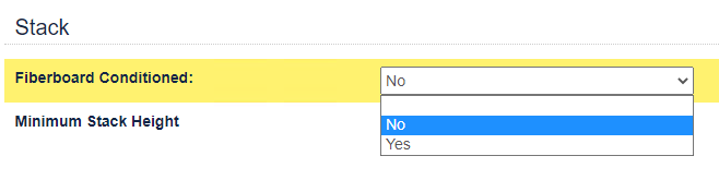

Case1: Lookup Rule finds 'No' for result. Choice for No moved to spot 1

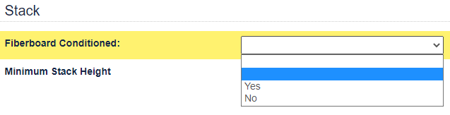

Case2: No results found, dropdown list reverts to it's default choices within the field.

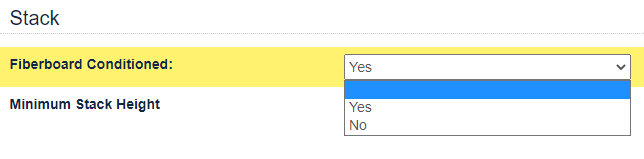

Case 3: Result it finds in lookup rule is empty (not null, but empty)
