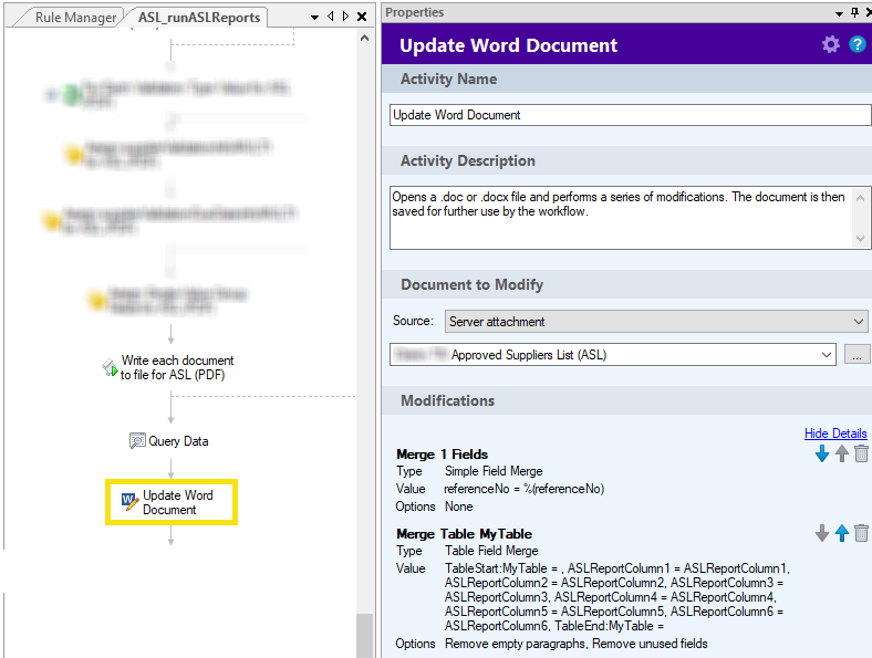

So I have a WF that runs a query in Laserfiche and creates a .csv report. That is working fine. The output is great! From there, I query for the .csv file and merge it with the Update Word Document.

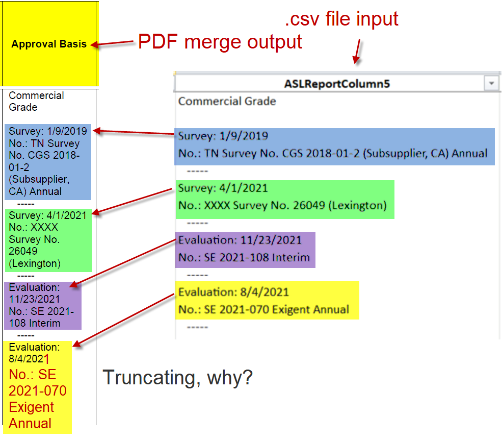

Here's my issue, when merging, it truncates ASLReportColumn5. As you can see below, my PDF output on the left truncates the data from the .csv input source. I have a lot of data going into other columns and do not have any issue. Don't know why it's happening.
This report actually has just under 100 rows but I'm providing the one row that's giving me a problem. BTW, I did a manual merge usng the .csv file with the merge file (removed the merge for reference info on the bottom of page 1) and it worked beautifully. So the issue is the "Update Word Document" in Laserfiche Workflow.

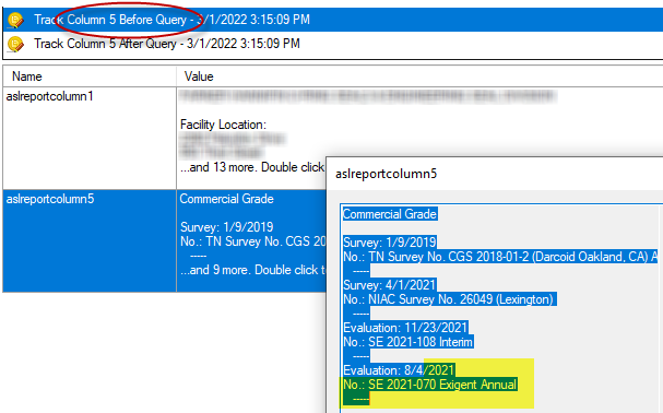

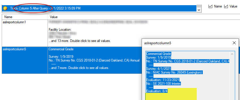

UPDATE! It is not the "Update Word Document" activity that is the problem ... it is the "Query Data" activity. I ran the following test:
Added a "track token" activity before running the query for the .csv file:
After the query, updated the value of Column 5 and tracked the new value:
I have submitted this as an issue to our Laserfiche vendor to review and escalate, if necessary. In the meantime, I'm going to try to create a Custom Data Query to see if that'll query properly.
