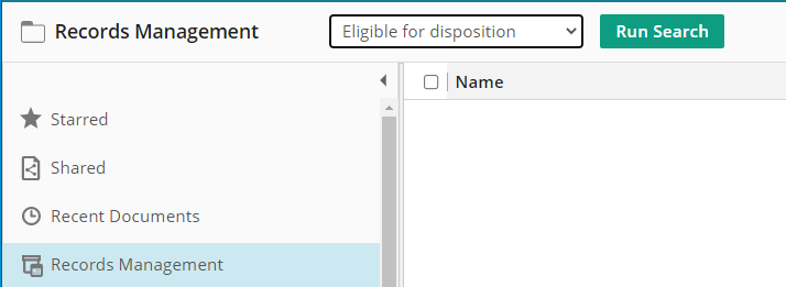

If you have an existing set of records ready for destruction, you can run a report in Laserfiche and bulk process them all that way. In general, destruction disposition needs to have a specific user affiliated with the actual action, so it's not exposed through a built-in Workflow activity.
One way of easily running this report is in the Laserfiche web client where you can access that directly from the top-level 'Records management' node as show here:
Do not run delete entry - that will bypass retention and not retain the metadata.

Thank you for the response @████████.  I have run such a report and it found over 6,000 records.  Unfortunately, it is very unwieldy for a user to manage a result set that large, so we'll have to narrow the scope in order to work with the records.
I've combined that search report with additional search terms to narrow down the result set so it's easier to manage, but the person responsible for the records just wants me to delete them all for her - hence my question on Answers.  I will let them know that doing so in Workflow will not maintain the destruction history or the metadata and go from there.

Alright. Keep in mind you can bulk destroy from within the repository report, so you don't have to go through one by one. The main thing is that it's often important to show who actually processed the destruction in the audit records, which wouldn't necessarily show coming from workflow (as a system user). So even if it's basically a bulk operation either way, it has a name associated with it in this case.
