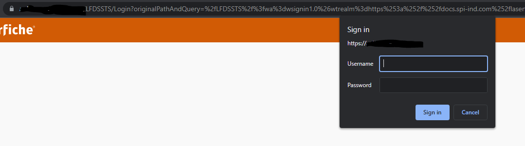

After an upgrade of the LF Services, all workstations  across the organization get the standard IIS Windows Auth prompt when visiting Web Client, meaning the browser is no longer able to acccess the credentials automatically.

Brian, What could have possibly changed in the update process that would change a configuration for this to stop working. I was on 10.4 for LFDS and Server and Web Client, pretty much everything and the auto-login worked. As soon as I updated to LF 11 for LFDS, Server, and Web client, it broke. It works when I'm on the server itself, but not on my workstation. I even tried rolling back web client to 10.4 and I'm still getting the popup. All my machines are on the same domain. and I have read the white pages multiple times and followed them. My users can log in if they type in their user name and password and if they open another tab, it logs them in just fine.
Even hitting the STS site causes the prompt to come up, And this was NOT a problem last week before my update.

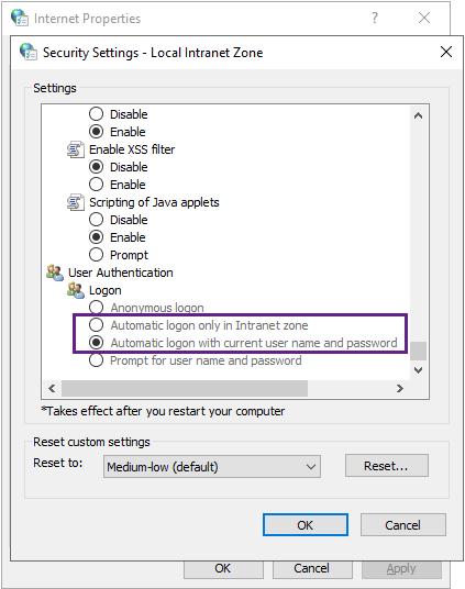

Any chance the URLs got changed at some point during the upgrade? Before worrying about what might have changed server-side, validate that the exact hostname (or matching wildcard entry) for the LFDSSTS URL is in end user workstation's "Local intranet" zone with one of these two settings selected:

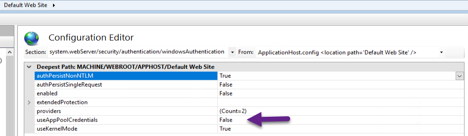

That said, sometimes what happens is that the clients attempt to automatically login, that fails, and the Win Auth prompt is immediately re-thrown. This can happen fast enough it makes it seem like the auto-login attempt isn't happening. Any chance you're running LFDS/LFDSSTS as AD service accounts instead of their default Network Service identity? Or changed the service/app pool identities in either direction during the upgrade? If you're using custom identities and tinker with the useAppPoolCredentials setting it's possible to screw things up:

Local internet is configured by group policies, so those are set and have not changed. I checked with my network admin and he ensured that my LF servers are in the zones.

In your screenshot of the IIS configuration Editor, are you saying that it should be False for useAppPoolCredentials? Mine is set to False.

Per https://techcommunity.microsoft.com/t5/iis-support-blog/setting-up-kerberos-authentication-for-a-website-in-iis/ba-p/347882, if you're using a domain account for the LFDSSTS, try setting useAppPoolCredentials to True so it uses the service account credentials instead of the machine account to decrypt the Kerberos ticket.
replied on February 22, 2022
I gave that a shot with no success. It seems like this bug is not on the surface with some easy settings. I have no idea what else to try. I have read the Configuring Kerberos for Laserfiche 10 document so many times.

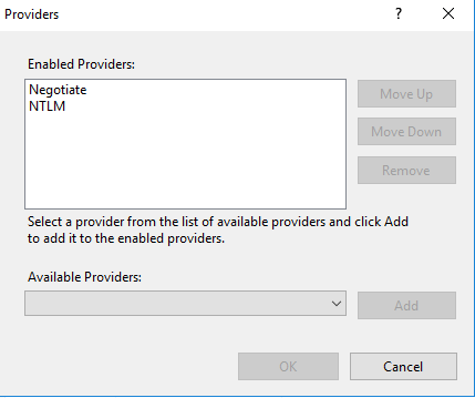

Brina and Samuel, I was able to get it working by rearranging the providers in the Windows Authentication options in IIS. All the LF documentation shows NTLM first and then Negotiate. As soon as I switched them and made Negotiate first, it started working.
I would recommend something in the installer that would leave these settings alone in IIS. Obviously, I had it working before I installed LF 11(LFDS and Web Client). I'm not sure which install did it or if both of them did it.
This is the screen I'm talking about.
