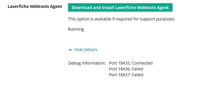

replied on February 17, 2022
From the web client, open the Options page and look under Advanced. You should see something like this:
The status should listed as "running" and one port needs to show "connected".
Perfect! Having them check this
