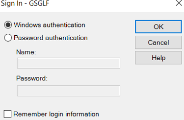

replied on February 15, 2022
As per attached image , for normal login we are passing username and password to validate user but self-hosted environment we does not required any values for windows authentication.
But for remote person who wants to login using windows authentication which parameter they want to pass in my API?

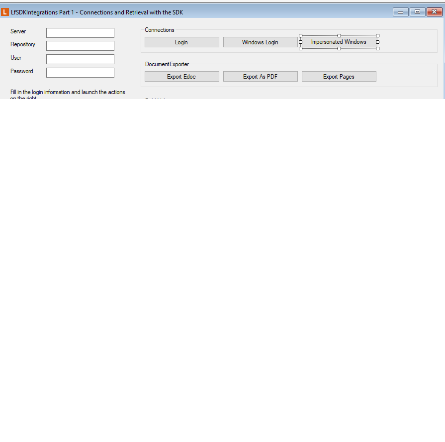

We have application installed on different machine and using the windows authentication we need to fetch Laserfiche folder structure via API which we have hosted on IIS.
My question is which fields we need to ask user to login in repository via windows authentication ? Do we need to ask all 4 parameter like servername, repository name , username and password like attached image.
if yes in username do we need to pass domain\username value ?
From screenshot , which method we need to  implement on asp.net mvc api code ?
Thanks,
pratik
Fill in the username/password fields to use impersonation in the sample project. Take a look at the sample code where it calls session.LogIn, it takes the domain credentials and logs in as that trustee.
