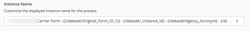

replied on August 1
Hey Larry,
It turned out to be a variable issue for me as well.  I had mistakenly used a variable (for a field that contained a huge amount of text) in the Process Options "Instance Name".   Updating the variable in the Instance Name to use the correct variable solved the issue.
Thanks for your post.  It lead me to a resolution.
