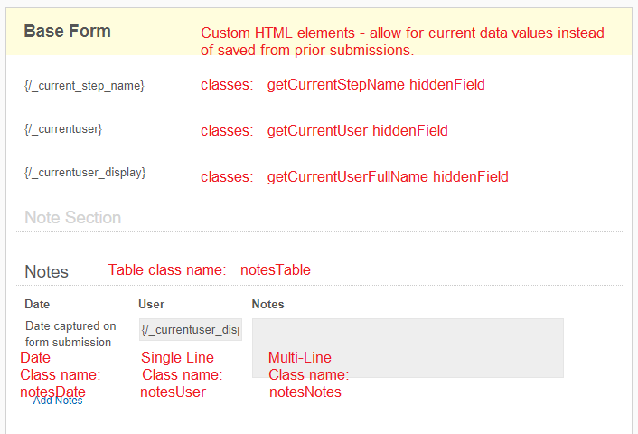

I'm still on verion 10.
I have a template that I use for every new form that has a notes table at the bottom. Users can add notes to the fields, like if they are doing an approval step and want to ask the initiator a question and return to them, or notes to explain what they are doing. It has Javascript that automatically posts a note when they Submit/Reject/Approve the task. I like this format of notes better than the built-in Comments.
The form also includes a bunch of CSS classes for laying out fields.

Javascript:
//add a note regarding form routing when the Reject button is clicked.
$(".action-btn.Reject").on('click', function() {
var noErrors = true;
//remove required fields - allowing user to reject form (cancel) without
//having completed all of the required fields.
//***REMOVE COMMENT CHARACTERS ON NEXT 4 LINES (AND DELETE THIS LINE) IN ORDER TO ENABLE THIS FUNCTIONALITY TO BYPSS REQUIRED FIELDS ON FORM REJECT
//$('*[required]').each(function() {
//$(this).removeClass('required')
//$(this).removeAttr('required');
$('#form1').parsley().validate();
$('.parsley-error').each(function() {
noErrors = false;
if (noErrors) {
//update the notes with the current action
if (($('.notesTable tr:last').find('.notesUser input').val() == $('.getCurrentUserFullName').text()) && ($('.notesTable tr:last').find('.notesNotes textarea').val() == "")) {
$('.notesTable tr:last').find('.notesNotes textarea').val("Task: " + $('.getCurrentStepName').text() + "\nFunction: " + $('.Reject').val());
else {
$('.notesTable .cf-table-add-row').trigger('click');
} //end of if...else... block
} //end of if (noErrors) {
}); //end of $(".action-btn.Reject").on('click', function() {
