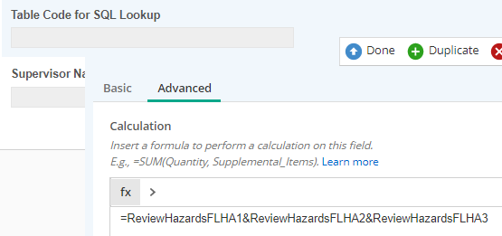

I have this working by having a hidden singleline field that gathers both the First radio button choice and then the Second radio button choices (different ones are unhidden depending on the choice in the first radio button).  It has this formula in it, which grabs both radio button choices:  =ReviewHazardsFLHA1&ReviewHazardsFLHA2&ReviewHazardsFLHA3
The problem starts when the user changes the first radio button and begins looking at some other choices.  Basically, the singleline field has already filled with the variables from the two radio buttons already picked and now, instead of clearing out and redoing the formula, it ends up adding to the formula.

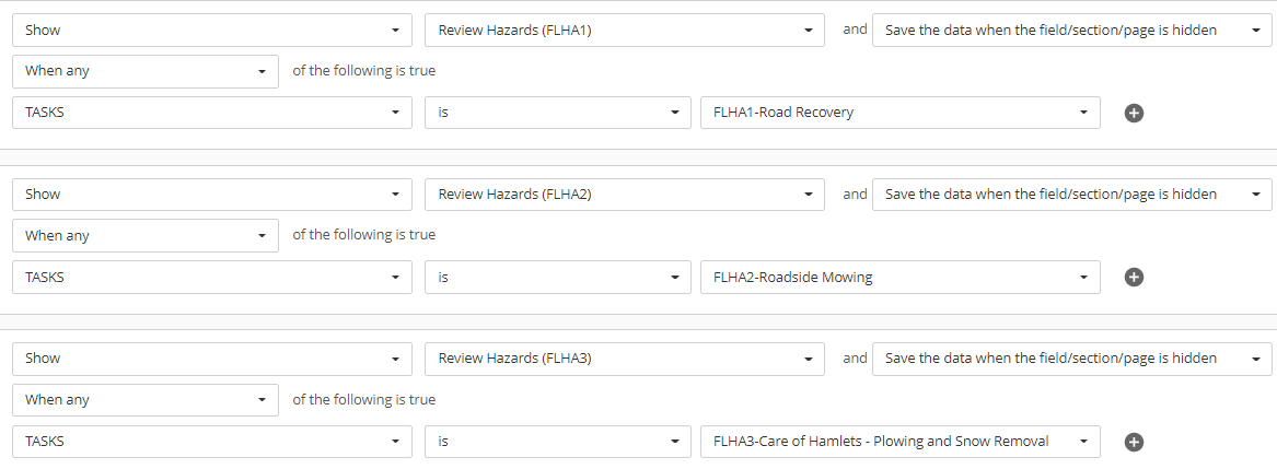

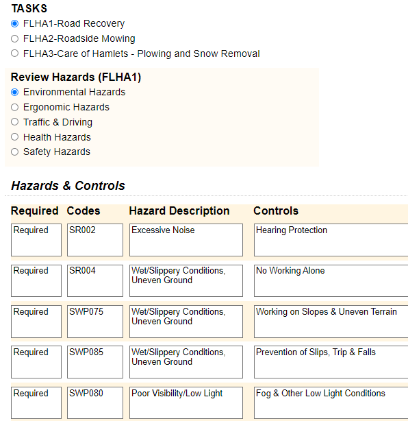

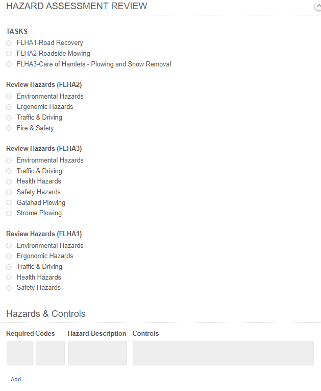

Hi Pieter, thanks for looking at this!  This form is a Hazard Assessment form where, first they pick the task, then start viewing the different hazard tables.  As they click into the five different hazard tables, the lookup fills the rows from the hidden database.  The lookup needs to know which TASK and which HAZARD in order to pull the right info.
This is my current (theory) test form showing below with only three tasks listed so far (there will be many more eventually).
Everything works beautifully as long as the person clicks on only one TASK and then starts reviewing the hazards.  They can change the hazard buttons as many times as they want and everything still works.  But if they try to change a TASK radio button, the lookup stops because now the hidden field is confused by the two choices (even though only one radio button is ever checked at any one time).
The singleline hidden field formula is:
