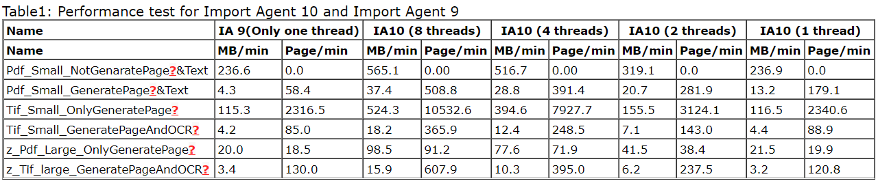

I'll also note that Import Agent 10 throughput scales well with cores/vCPUs up to four, after which the marginal benefit of each additional core falls off hard. Two machines running Import Agent, each with 4 vCPU, will have something like 60-80% higher throughput than one machine with 8 vCPU.
Don't have Import Agent do page generation for the migration. It'll slow down your import throughput by an order of magnitude or more. If you need page gen, use DCC with Workflow on the backend.

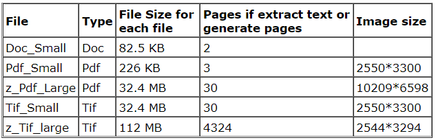

@████████, you're definitely getting bottlenecked somewhere outside Import Agent, assuming you aren't generating text/pages like I mentioned earlier. Below are throughput results from Import Agent multi-threaded performance testing we ran some years ago. The first line, "Pdf_Small_NotGeneratePage&Text" shows 516.7 MB/minute (31 GB/hour) for Import Agent 10 with four threads. Note that there is a 20x drop in throughput for the next test with page and text generation.
