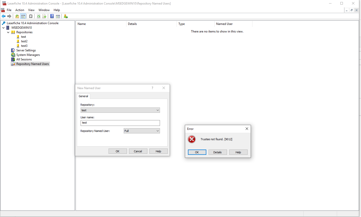

Using Laserfiche 10.4. I've installed everything I think I need. I log into the Admin Console with system manager account. I create a repository. But how do I create a user to access the repository? I can't create an user using this guide because I need to be able to log into the repository in the first place which I don't have access to: https://doc.laserfiche.com/laserfiche.documentation/11/administration/en-us/Subsystems/LFAdmin/Content/Creating_a_User.htm#tabs-1 . I understand I can't log in with my systems manager. Is there a way to manage users within Laserfiche that I am missing?
I try to add a new Repository Named User but get a "Trustee not found [9012]" error.
Error Code: 9012
Error Message: Trustee not found. [9012]
------------ Technical Details ------------
LFSO:
    Call Stack: (Exception)
        LFSession::ProcessResponse
        LFSession::SendRequest (POST /+LF/lfnameduser)
        CLFLaserficheNamedUserCollection::AddLaserficheNamedUser
    Additional Details:
        HRESULT: 0xc0042334 (LFSession::ProcessResponse, lfsession.cpp:3901)
         (LFSO/10.4.2.89)
LFAdmin.dll (10.4.2.236):
    Call Stack: (Current)
        CLicenseLFNamedUserPropPage::OnApply
    Call History:
        CLicenseLFNamedUserPropPage::OnInitDialog
         CLicenseLFNamedUserPropPage::PopulateRepos

Newly created repositories have a default user called "admin" with no password. You should be able to log in that way.
replied on February 3, 2022
Ahhh, not sure how I missed that. Thanks!
