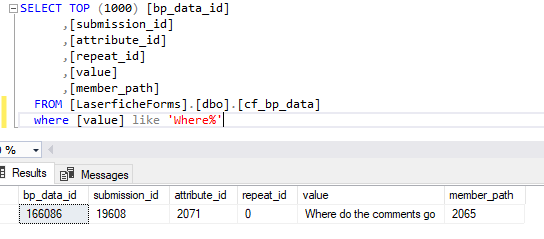

Thanks James, cf_bp_data actually contains the process variables data which we can find through attribute_id and submission_id but not the comments. I found out that comments are stored in cf_submssions.
So I had to get my comment from cf_submissions table. I just got the last comment if any in my case. And then I updated the variable of the process in cf_bp_data against it's attribute_id and submission_id with that comment. I also updated the formatted_variables table agianst the attribute_id and bp_instance_id because the custom report won't be able to perform a search on field without it.

replied on February 3, 2022 Show version history
Well, it looks like the comments are stored in cf_bp_data.  You'll need to determine what your business process id and attribute id are.
