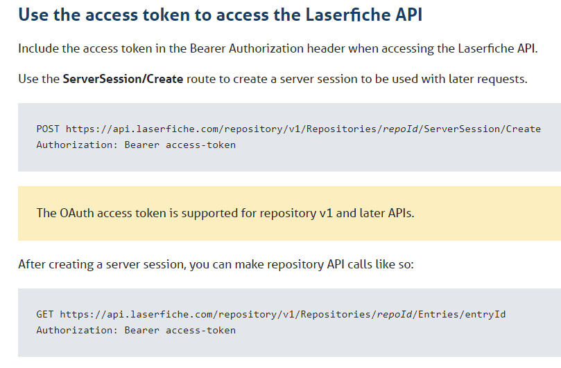

It seems like you were able to get an access token - an earlier version of your post said you were having problems with the POST request from step 6.
If you were able to get an access token did you create a "repository session" as described in documentation page from my previous reply?
It would be easier using the library which wraps these http requests:
https://support.laserfiche.com/download/4166
replied on February 4, 2022 Show version history
Thank you, works now! I had missed that final part, sorry. I was also able to successfully save the tif from the "value" URL.
