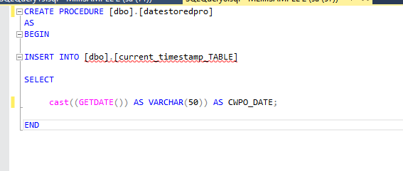

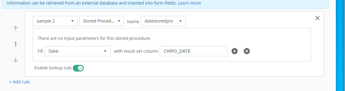

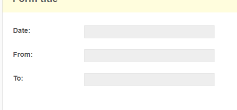

Hi James Adamo I using Stored procedure to get the latest date and time also use the Look up rules to Get the date and time from stored procedure and display to Date field, but sadly it did not display into Date field what to do ?
Here's the screenshot.
Stored procedure for date

Layout
Look up Rules

replied on February 3, 2022 Show version history
It is probably a format issue.  I usually use DATETIME2 as the data type.  I would execute the query in server management studio and check what the string representation is.  Also rather than GETDATE() try SYSDATETIME().  Try something like this:
declare @jimte  date = sysdatetime()
select @jimte
--or--
select convert(date, sysdatetime());
