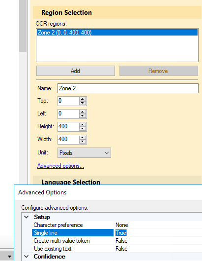

A common practice is to use an oversized zone OCR zone to capture just *some* of the text (instead of matching the whole page), then using pattern matching to filter it down further.
4) If you're using zone OCR and you want to capture multiple lines (e.g., your zone is large like suggested in #3), set the advanced option "Single line" to false (it defaults to true)
