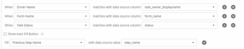

I should probably explain my process a little bit. This process involves 3 forms. This is a vehicle inspection process, in which a driver needs to perform a morning inspection prior to driving, and an inspection at the end of the day when they're done. What we do is allow the driver to submit this form as many times as they want, and it gets routed back to their inbox until they give us their ending miles, and fill out a signature field. The customer didn't want the 'save as draft' button on the form - they just wanted one button, so we opted to do it this way.
There are 4 pieces of information I'm using to perform this lookup. We populate a driver name field with {/_currentuser_display}, we populate a hidden field called Task Status with the value '2,' and we populate a hidden field called Form Name with value 'Form2 Name.' My lookup rule looks like this:
The task_owner_displayname column in the view contains the same value that's being populated by in our Driver Name field - in this case, it's the name of the driver who's been assigned this task because they haven't provided the ending miles and they haven't signed it. The form_name column contains the name of the form that's assigned to the user - we assign a separate form (Form2) to the driver after their initial submission that doesn't contain any of these hidden fields. The task_status column appears to simply contain the value '2' when I look at a row that pertains to this user task (I'm not sure that I need this column now that I'm describing it).
So, if we find a match and fill that form field with what's in the step_name column, it seems to indicate that this user still has a user task to complete within this process. If the Previous Step Name field is not blank (because the lookup populated it), I show a custom HTML field with a message saying something like 'you still have an inspection to complete. Please go to your Forms inbox and complete it.'
