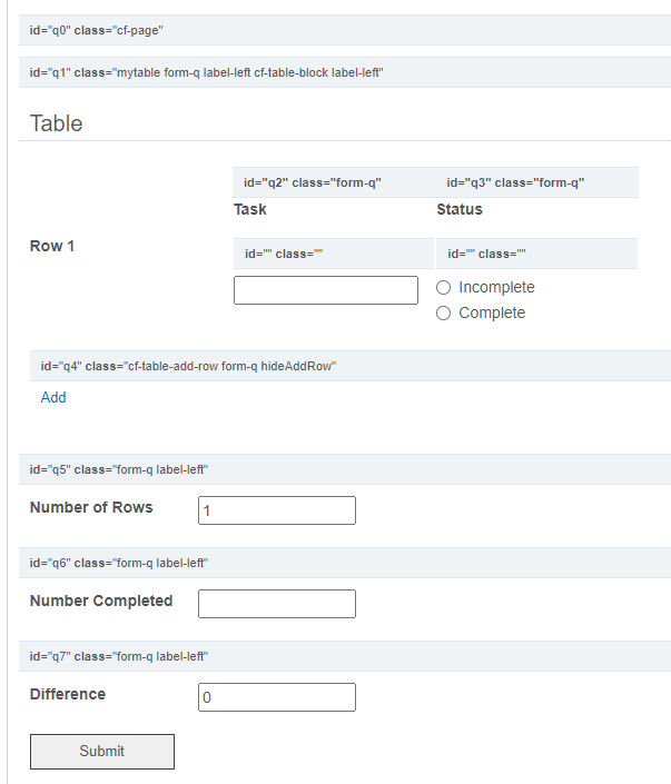

Here's the Javascript that will fill in the Number of Rows:
  rowcount();
  $('.mytable').on('click', '.form-del-field', function () {
    rowcount();
  $('.mytable').on('click', '.cf-table-add-row', function () {
    rowcount();
  function rowcount() {
    $('#q5 input').val($('.mytable tr').length-1);

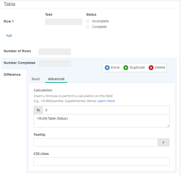

Here is the calculation for number of completed status values:

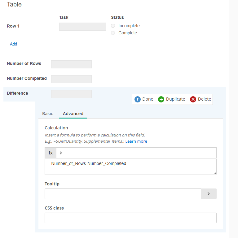

Here is the calculation for the difference

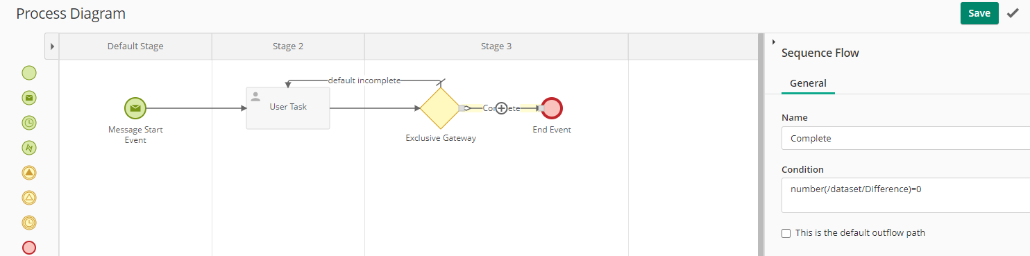

And here is the process diagram:
It worked for me.
replied on January 21, 2022
Interesting, Katy!  Thanks for all that.  I am able to match what you've done and will be able to use it!
I have one question:  In your JS, what field is #q5 Input?
replied on January 24, 2022
The Number of Rows:

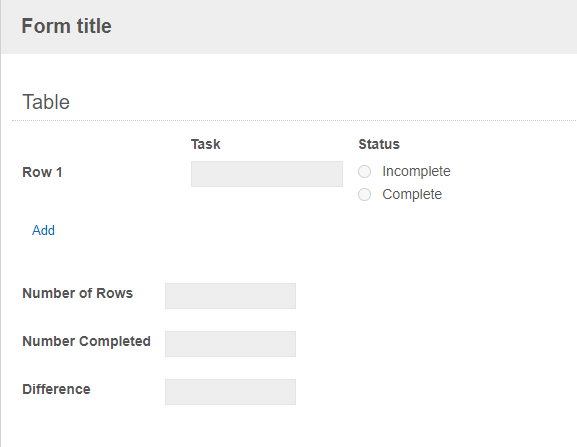

replied on January 18, 2022
Do you have a picture of this field/table?

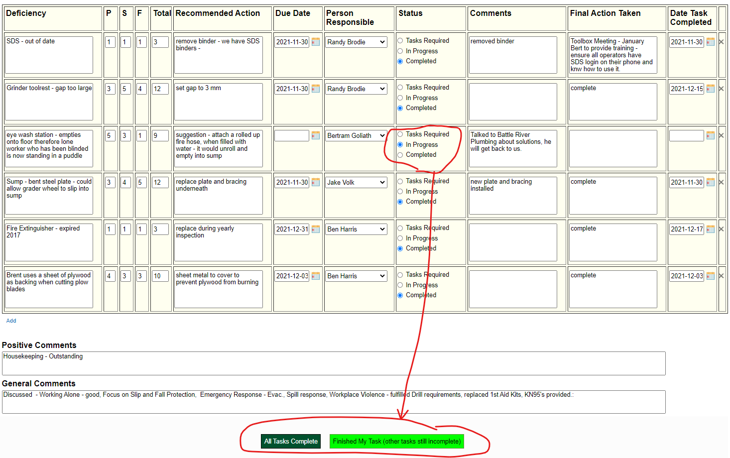

replied on January 19, 2022
Here you are Katy.  My goal is to get the form to know to move out of the loop to the final steps once ALL the Status buttons show as Completed.
Thanks, Chad!  So, I know enough to know that if I use this as is, it won't work bc there needs to be more parts.  I have other JS on the page, but just something small.  So I'll need to start this one with the same beginning of the other one, right?
$(document).ready(function ()
and end it with something that tells it what to do after your if statement.  How would I tell it to make the second submit button show up instead of the first one if the if-statement is true?
  • Finished My Task (other tasks still incomplete)
  • All Tasks Complete
