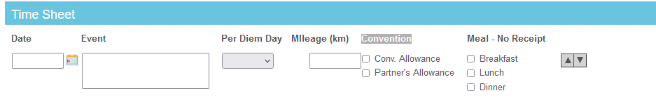

Here is the original table called Timesheet.
In a separate table, I need to assign a value of 30 if the Convention column is "Conv. Allowance" in the original table. I will need to do this for the Partner's Allowance as well, but it will have its own column.

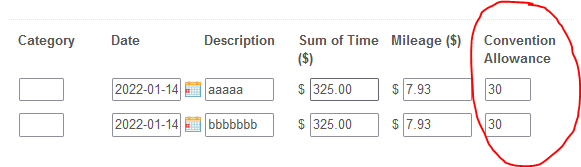

My problem is that it is filling 30 for everything, regardless of the selection in the Timesheet table.
