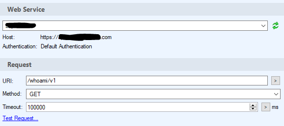

  • What goes in the "Host" setting in the Web Service task?  Is it the URL for the server running the API (in this case, our Oracle server), or is it one of the already configured web services such as the Forms server?
  • What goes in the URI field in the Request section?  Is that for the URL to the API?

The Host (configured from Web Service) and URI (set in the activity in Forms) fields combined are the URL that is being accessed for the API.
Let's say for example that your API is called via URLs like this:
https://www.fakesite.com/api/tenant/lookup
Then you'd likely want to set your Host as https://www.fakesite.com and the URI as /api/tenant/lookup.
The EXEC commands you listed don't seem to include the URL (the second one just lists @URL), so I can't speculate what you need to list for those values.
Four of the EXEC commands that you listed are header values - which Workflow does in the "Request Headers" section.  Look at my screenshot #3 - what I have listed there for authorization via a Bearer token, should be equivalent to the 4th EXEC command you have that is setting Basic authorization with a token.  You would set the Authorization header to be "Basic zzz123abc456yyyyxxx9876".  You should be able to set-up all four parts of the header that are shown in your EXEC commands 3-6.

Thanks for the clarification.  The URL being passed for the @URL parameter is http://xxx.com:9184/jderest/orchestrator/TA_FA_AP02_ORC_MatchPO (I replaced the host name with xxx), so it sounds like the host is http://xxx.com:9184  and the URI would be /jderest/orchestrator/TA_FA_AP02_ORC_MatchPO?
replied on April 28, 2022
Yes, I believe so.
