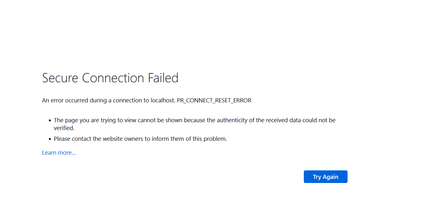

After installing LF web client I try to set up the configuration to LF web client, I don't use any certificate on IIS
Every time I try to access it give me this error attached, When I try to connect with HTTP only not HTTPS return write the same URL with HTTPS and the same error
I tried to uninstall the Web client and reinstall and the same error occurred.

This is not an issue with the web client.
Is this Firefox? Does it happen in all browsers? Usually this is caused by something interfering with traffic between the browser and the server, like the firewall or the antivirus, and sending in their own certificates instead of the server's certificate. In some cases, browser extensions could also do this sort of traffic filtering.
replied on December 22, 2021 Show version history
To add to this, if you are seeing HTTP turn into HTTPS, it looks like either your browser or your server where the webclient is installed has an HTTPS redirect turned on.
HTTPS redirect can be set in IIS for all people accessing the site, or can be done in the browser on just your computer.
Since you do not have a certificate in IIS and you are getting redirected to the HTTPS version of the site, it will fail.
We strongly recommend always setting up HTTPS, and it seems like that's a default for you as well, since the HTTPS redirect is happening. As such, I recommend setting up an IIS certificate for HTTPS as a first troubleshooting step.
Beyond that, as Miruna noted, this is not a Laserfiche-specific error, so if that does not resolve the issue, I would look into IT policies, try other browsers, etc. to pinpoint the issue.
