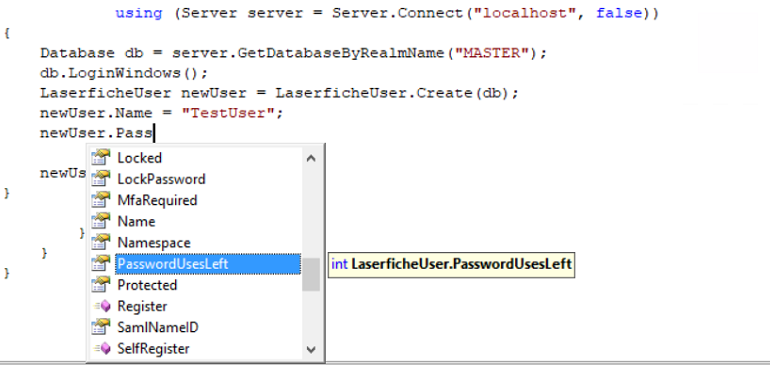

I do not see Password as an option

Yes, that is in Workflow, not sure why it hides Password but shows the others. Maybe it does not show inherited items.
replied on December 21, 2021
It does work if I type Password and compile so that is helpful, now the new user has a password assigned.
