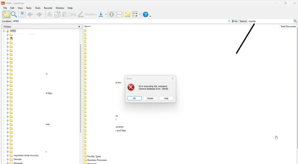

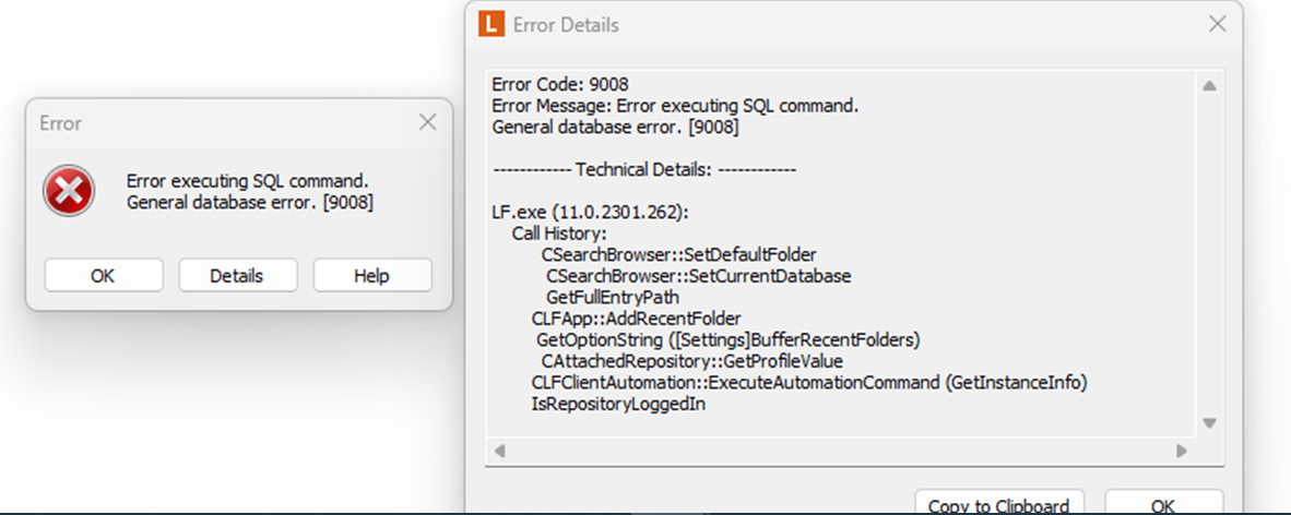

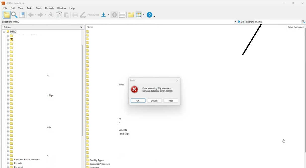

We are facing a General Database Error [9008], on different computers while searching.
We are using the Laserfiche version 11, and Database is SQL Server (SQL 2019 CU 14 Standard).
The search criteria is Field Search and Field is EmpID. The Template Fields are already set to indexed.
Additionally, Whenever we reset the Client settings, it works and search the data for the first 5-6 queries later on for every query it start giving the Error [9008]. The Detail error is as follow:
Error Code: 9008
Error Message: Error executing SQL command.
General database error. [9008]
------------ Technical Details: ------------
LF.exe (11.0.2103.223):
    Call History:
        CSearchView::OnSearchDone
        IdleTimerProc
        CFolderListCtrl::Refresh
         CFolderListCtrl::LoadContentsHelper
          CTocCacheWorkerThread::SetDatabase
        CSelectionProperties::GetFlags
        IdleTimerProc
        IsRepositoryLoggedIn
##Laserfiche Client
Error Code: 9008
    Call Stack: (Current)
        CSearchView::RunSearch
        CSearchView::BeginSearch
    Call History:
          CLFClientAutomation::ExecuteAutomationCommand (GetWindowInfo)
           GetRepositoryProperties
            GetOptionString ([Settings]CloudCustomer-kcc)
          CLFClientAutomation::ExecuteAutomationCommand (GetInstanceInfo)
          CLFClientAutomation::ExecuteAutomationCommand (GetWindows)

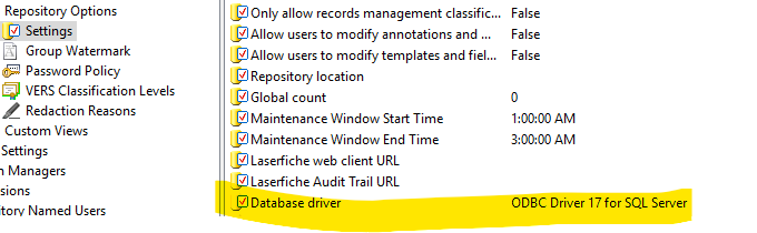

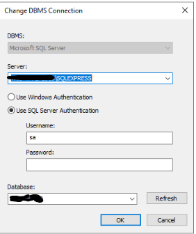

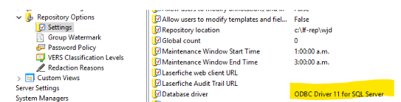

I came across this thread after having the same issue for a client of ours. I did an in-place upgrade for them from 10.4.3 to 11 and users started experiencing the general database error. After reading this thread I was reluctant to enable the LCE, so I asked some colleagues if they have enabled it before. Luckily enough, they ran into this issue and the following solved it for them and for my client. So the credit goes to them.
When you do an in-place upgrade, it seems that the database driver doesn't update in the Administration Console. I'm not sure if this happens every time or just to us lucky ones.
If you use the change db connection in the administration console and just re-pick your database settings, it should update it:
Now it's showing driver 17 and the users are no longer getting the general database error.
Hope this helps the next guy!

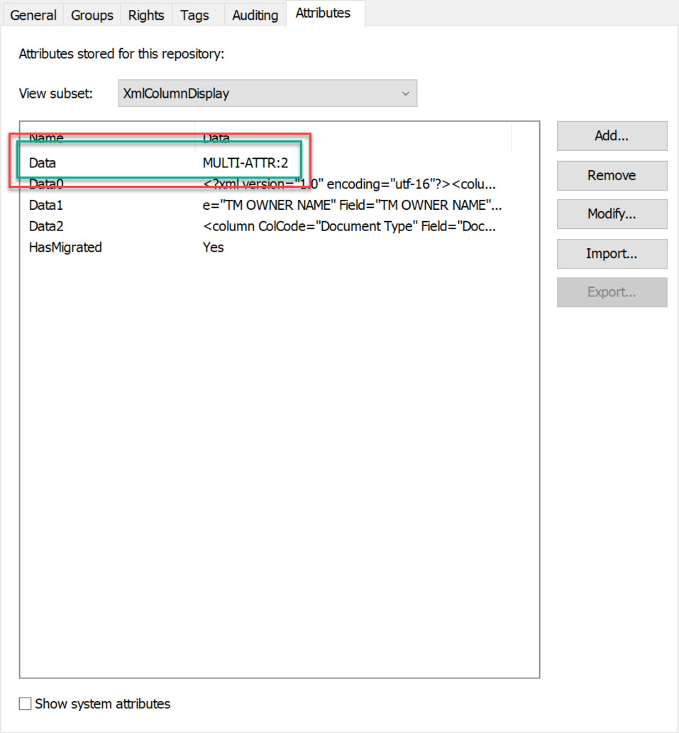

replied on December 20, 2021
I resolved this issue for one of our users by wiping out the account attributes. Once done, the search error went away.
replied on December 20, 2021 Show version history
If that is using tools-options-reset in the client then it will likely just come back.  I reset my client last Thursday and searches began working again and were fast.  However, it is Monday today and the error is back.
Another odd thing is I will get the error logging in to 2 different machines.   My laptop is one and the other is a virtual machine.  I use the same login credentials in both cases.  Once I reset the client on my laptop searches begin working for both the laptop and the VM.
This only started happening to me once I moved to Laserfiche 11 client.  The server has also been upgraded as well.
I took it as LF Admin Console, user properties, attributes. It is also per Repository.
I tested this by removing all attributes from one of my users and the searches worked. Now it is going through them all to try and figure out which of them are the cause.
Edit:  You can view just the attributes related to Search from a drop down list.  I also had a weird problem with OCR on dragging and dropping files into LF that was fixed by removing the attributes for OCR.  Didn't even think about it until the Search removal worked and I saw OCR listed.  Both errors came up after updating to version 11.
replied on December 22, 2021
I'm that user ;)
You are correct - in the admin console.
So far it is still working well.
But, when I restore my exported attributes, it still has the problem. So I removed the Search attributes and that ... didn't fix it!
By chance, I then removed the XmlColumnDisplay attributes next and it DID fix it!
For me, as a user sample as one, I narrowed it down to the attribute in
XmlColumnDisplay:
Data: MULTI-ATTR:2
I've now restored that attribute twice and it causes the search to fail, while removing it fixes search!
Steve

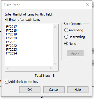

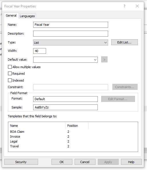

I know upthread some people have said that there are particular column headings causing the issue in some cases. (I know headings that involve calculations such as the 'Total Document File Size' can cause it to happen.) In our case it is our 'Fiscal Year' field which is part of our Invoice template. I was wondering if there was anything peculiar about it that might cause the issue. Here is how the field is set up:
It's a "List" field which means it appears in a drop down box when doing searches. The 'Blank' option is checked. The field is used in four different templates.
One thing I noticed that is probably 'bad form' is that we left the Width of the field at 40 when it obviously doesn't need to be that long.
The other thing I noticed is that all the values are very similar to each other: They are always 201X or 202X where X is the last digit in the year. Could that matter?
The error pops up when browsing the repository but sometimes it takes a couple of tries. Even when the error doesn't pop up, searching feels very slow. If I remove the 'Fiscal Year' column then suddenly all searches are lightning fast. Almost instantaneous.
Document counts by template:
BOA Claim - 1330
Invoice - 43,480
Legal - 4460
Travel - 1397
So, that's a total of 50,667 documents. Not an astronomical number for the documents that use these four templates.
Does anybody see any commonalities between the fields that throw the error for them and our 'Fiscal Year' field here?

My server is LF 11 and I've tried both the 11 and 10.4 clients. At the bottom of the error in the event log on the server (after all the query text) I see the timeout is set to 15 seconds?
...order by q1.row_num"; Timeout=15(sec).
I know I'm doing a query that might take a little time. I'm asking the search engine to traverse 636 folders and inspect 14,482 documents with 179,620 pages and return to me any that are over a certain size (or even worse, greater than nn and less than nnn!).
But I'd rather not break it up into smaller chunks of search. I'm ok with it taking a minute or two.
Steve

The details are recorded in the LFS event log. It is most often a timeout, but this is the generic error for any unexpected SQL failure.
replied on February 1, 2022
Ah ok so it is a timeout in my case, that helps explain things a lot. The time outs for large searches are very short, around 15 seconds. So SQL is getting the job done, but the app is impatient.

This error is still on the go. It happens when users using the quick search. Doesn't happen all the time, but occasionally. Since we updated LF 11, this error randomly appears. We opened a support case with our provider but there is no tangible solution to it.
This is what it shows on the error log;
"Timed out when executing an SQL query.
Session ID=186968; Dialog ID=20989173; Repository="PFC"; Function=SysEntryOpenListingStreamEx; Message="[Microsoft][ODBC Driver 11 for SQL Server]Query timeout expired"; Statement="select id,link,type,flags,sdctl,rfid,parentid,toc_uuid,toc_owner,isFrozen,recordState,hasacl,c0,c1,c2,c3,c4,c5,c6,c7,c8,c9,c10,c11,c12,c13,c14,c15,c16,c17,c18,c19,c20,c21,c22,c23,c24,c25,c26,c27,c28,c29,c30,c30_count,c31,c31_count,c32,c33,c34,c35,c36,c37,c38,c39,c40,c41,c42,c43,c43_count,c44,c45,c46,c47,c47_count,c48 from (select toc.tocid as id,toc.linkto as link,toc.etype as type,toc.toc_flags as flags,toc.toc_sdctl as sdctl,toc.rfid as rfid,toc.parentid as parentid, toc.toc_uuid as toc_uuid, toc.toc_owner toc_owner,case when toc.tocid in (select tocid from frozen) then 1 else 0 end as isFrozen,case when toc.rfid is null then 0 when toc.isDispositioned = 1 then 4 when toc.iscutoff = 1 then 3 when toc.isclosed = 1 then 2 else 1 end as recordState,case when toc.toc_flags & 32 = 32 then 1 else 0 end as hasacl,case when linktoc.etype>=0 then 1 else 0 end as isfolder,toc.tocid as c0,toc.name as c1,linktoc.edoc_ext as c2,toc.parentid as c3,toc.etype as c4,case when linktoc.edoc_storeid is null then null else case when linktoc.edoc_size is null then 0 else linktoc.edoc_size end end as c5,linktoc.etype as c6,toc.etag as c7,toc.linkto as c8,case when linktoc.etype = 0 and linktoc.rfid = linktoc.tocid then 320 when linktoc.etype = 0 and (linktoc.toc_flags &  1) = 1 then 257 when linktoc.etype = 0 then 256 when linktoc.etype = 1 then 384 when ((linktoc.edoc_mime IS NOT NULL AND linktoc.edoc_mime <> '') or (linktoc.edoc_ext IS NOT NULL AND linktoc.edoc_ext <> '')) and (linktoc.toc_flags &  1) = 1 then 17 when (linktoc.edoc_mime IS NOT NULL AND linktoc.edoc_mime <> '') or (linktoc.edoc_ext IS NOT NULL AND linktoc.edoc_ext <> '') then 16 when (linktoc.toc_flags &  1) = 1 then 1 else 0 end as c9,toc.created as c10,case linktoc.etype when -2 then linktoc.pagecount else null end as c11,linktoc.vol_id as c12,linktoc.pset_id as c13,(select hc.hitcount from searchresult12 hc where hc.rsid = sr.rsid  and hc.tocid = toc.tocid) as c14,toc.name as c15,0 as c16,1 as c17,toc.toc_uuid as c18,plock.owner  as c19,cast(null as varbinary(85)) as c20,0 as c21,case when linktoc.final_date is not null or linktoc.isdispositioned = 0 then linktoc.final_date "
I really hope it would be solved one day

Have you tried updating your ODBC connection for that repository as mentioned previously in this post so it uses the ODBC 17 driver instead of 11?
replied on February 29, 2024
Hi Blake, I'm sorry for the late reply, yes we updated to ODBC driver 17 for SQL server recently. We realized that the search seems to be a bit faster than usual but when we put conditions to search for high amount of files with many columns, we still get the error. Especially if one of the columns is "Total Document Size" it almost guarantees the error. We try to run the high amount file searches with minimum column displays then at least we get a result.

This may be the same issue as some earlier comments on this post, recommending to upgrade from ODBC Driver 11 for SQL Server to version 17.  The version is listed earlier in the text of your error message.
Some of the more recent comments on this post (mine included) mention still having the issue after upgrading, and not having a solution, so that may not resolve it.  But it is worth trying…
replied on September 6, 2024
I have 2 customers experiencing this issue also. upgrading to ODBC 17 did not help.  This issue seems to happen when there is nothing chosen in the search fields.  So if your were just searching for all documents by template the search would error out, but if you selected a field on the template and put in some information, the search completes.

One things I've noticed during troubleshooting is the attributes on the user account can trigger the timeout error. In the past we've deleted and recreated the user account with bare minimum attributes and they don't encounter the issue.
replied on October 4, 2024
Years ago I'd narrowed it down to the XmlColumnDisplay attribute. Next time try just deleting this one and see what happens.
I wonder if setting up a SQL job to delete this attribute when it pops up would "fix" this?
Yeah that rings a bell - although don't think the attributes are stored in SQL directly, I know we have an SDK script for setting up attributes.
