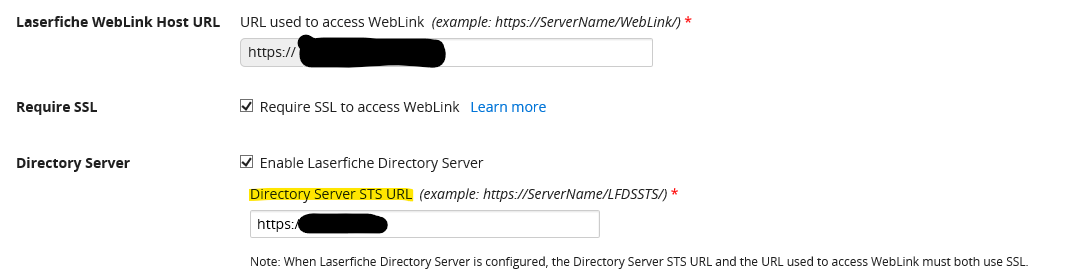

replied on November 29, 2021
You should be able to set this up in the connection settings through the WebLink designer. We currently have a similar setup with Forms and WebLink instances on a DMZ server and they both use an STS page installed on the DMZ server for LFDS authentication like you described.
