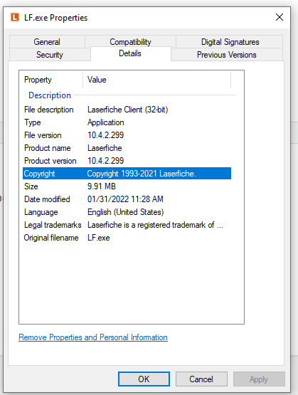

replied on March 23, 2022
Hi Jeff,
Yes there is a fix for 10.4.2.  I've uploaded a copy of it to this post (It's a zip file with a .TXT extension in an attempt to get around the rules).  If you can't get at it, I'm sure support can able to provide the LF.exe.  You replace the 10.4.2 client's lf.exe file with this one.
replied on March 25, 2022
Thanks Patrick
Passed this along to our Customer to try
