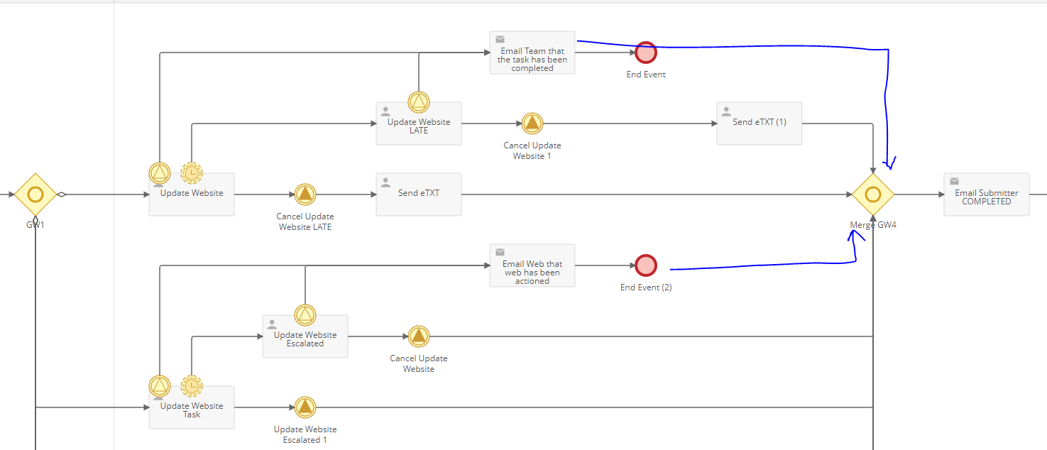

Am I right or am I wrong? Attached a screen grab of a forms workflow, and I think I have got it wrong.
I have some escalation and then some signal events to cancel tasks if the original task is completed. I suspect that my whole use of signal throw/catch may also be flawed.
My question however is that I do not want to end the whole process. Should the branch flow to an END event, or should I tie it back to the main process (as per blue arrows).

The catches should run to an end event. It won't end the whole process just that active process line. You have multiple active branches when you interrupt.
