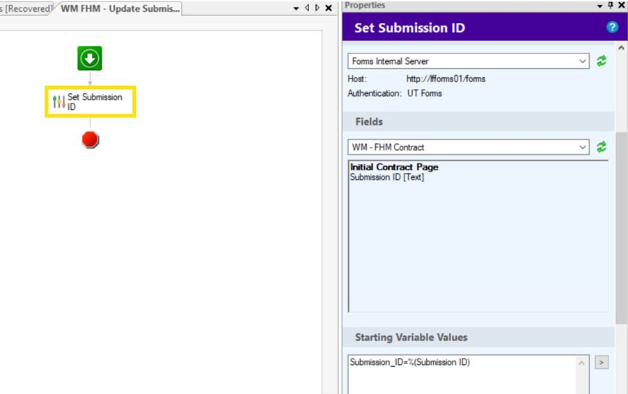

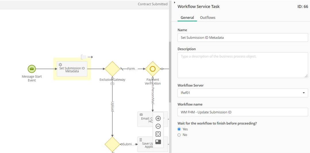

I have a process which I have been testing and it has been working perfectly.  Yesterday, when I uploaded the existing cases into my new form process, I found that all entries are failing to complete the first workflow step.  I cleared all the imported records and attempted to start the process with a manual form submission and that is also now failing. I discovered the failures started sometime on Monday afternoon.
This is the step which is not working along with the workflow which it is calling (neither is complex).  I KNOW that everything would say I must have changed something somewhere, but if I did, it was purely unintentional and I wasn't actually working on the process at all that day, so I am lost.  No error messages, the task just stays in a perpetual processing state.

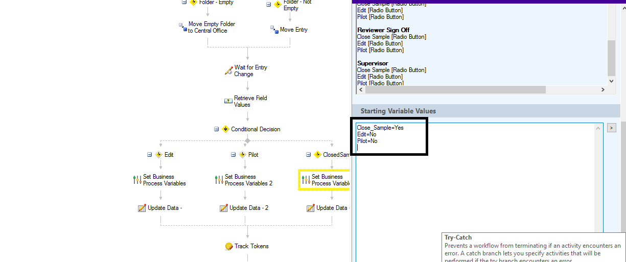

I just had this same issue this morning on our Laserfiche 11 test environment using a workflow activity that contains a "Set Business Process Variables". The workflow completes according to Workflow Logs, but the signal to "release" the workflow activity in forms never makes it back so it remains "In Progress".

I was able to resolve the issue at my end by removing any variables under [Starting Variable Values] that were being set to blank using %(DB.NULL). Not sure why, but it looks like that special variable causes the Set Business Process Variables to hang. You may want to also try removing references to system variables, and use Tokens only. Or, alternatively, bridge a system variable to a token and then use the token instead.

Yeah I noticed that in your original screenshot which is why I mentioned trying to bridge it using a token, in case it was an issue/bug setting special/system variables directly using the Set Business Process Variables activity.

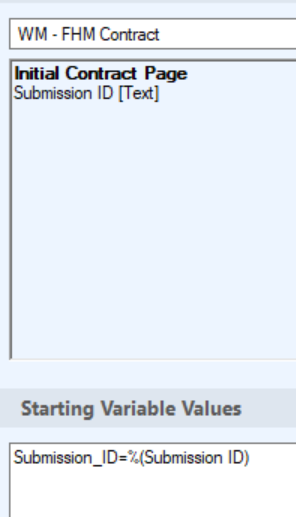

Kris, I am not sure what you mean by bridging unless you mean creating a token that is populated with the submission ID from the input parameters of the form.  Then using the token to update the business process variables.  I have already tried that.  Actually, on every workflow log and in every attempted means of updating the variable, the output is logged as the accurate number.
