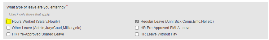

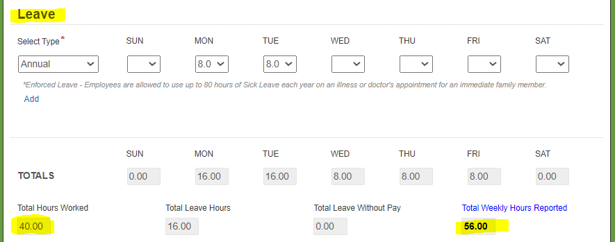

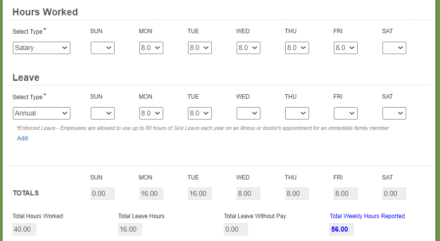

I have several tables that are totaled together for capturing weekly timesheet hours.  If the user enters time on one table, then decides they didn't want that table so they uncheck the table option, how can I automatically Clear the Values they previously entered so they will not reflect in the totals.
So in example #1 below, obviously Mon and Tues time entry is a mistake. That can be easily corrected.
Selection boxes: (these are used for routing tasks)
Here is the problem, when I go to the checkbox and remove the Hours Worked (to only show leave). If I don't manually remove the hours it will still adds to my total calculations, how can I tell it to clear the values if Unchecked?

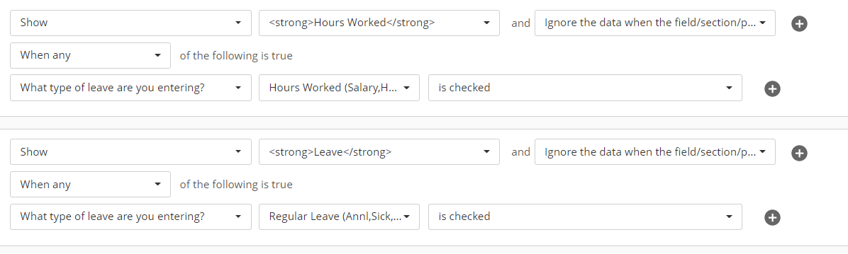

replied on November 2, 2021
I'm assuming you're using Field Rules to hide the table when the box is unchecked. For the rule you need to choose "Ignore the data when the field/section/page is hidden." This won't clear the table, but it should ignore the data used in the calculations.
Steve,
Yes, that is selected within the field rules, and I thought that too. But it is still adding to the totals.   The totals are separate fields and not part of the Table.
thanks!
Are you using a formula on the "Advanced" tab of the "Total Hours Worked" field to sum the table, or using Javascript?
replied on November 3, 2021
I'm using formulas on the Advanced tab.
