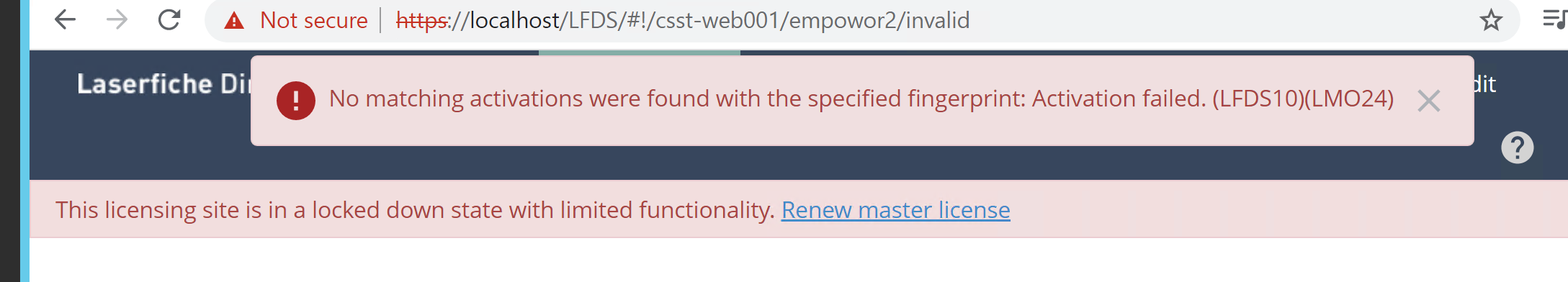

HELP no matching activations were found with specified fingerprint
asked on October 16, 2021
IT made a change to MAC address on server last night.   now my LFDS says it is in a locked down state with limited functionality. Renew master license
when i try to renew it says No Matching activations were found with the specified fingerprint.  which is true, i'm sure.
but how do i get the new fingerprint so that i can renew the license.
I'm a bit desperate; i have people working this weekend and I have never actually worked in LFDS before so i'm really stumbling around.
Any direction to articles or step by step hints would be greatly greatly appreciated.

You can go to the machine that installed Laserfiche Server and get the showhwfp.exe from C:\Program Files\Laserfiche\Server and run it on the machine LFDS installed to get the fingerprint.
