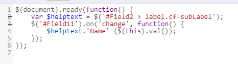

I'm sorry but I can't figure this out probably because I'm new at coding in LF.  I have tried numerous changes to the "$helptext." line and still can't make it work:
I show the "Text Below Field" as subLabel and the "Text Above Field" as textHelp when I inspect the form. The Badge Number" field is #q2/Field2. when a person enters their badge #, their name is populated into #q11/Field11. The variable for that field is "Name"

replied on October 13, 2021 • Show version history
$(document).ready(function(){
  $("#q11").change(function(){
  	$("#q2 .cf-helptext").text($("#Field11").val());
I was able to get it working by setting the .text to the value of the hidden field. You can try this and test it if your form routes to others to make sure that .text set holds. You may have to play around with it some more to get it to hold throughout the form process.
Edit: This worked for me because I had a default sample text already in the bottom of that field and javascript changed what was there. If you do not set something in that field by default, Forms may not draw that at all in the dom in which case you would not be able to set/change the text with javascript.
