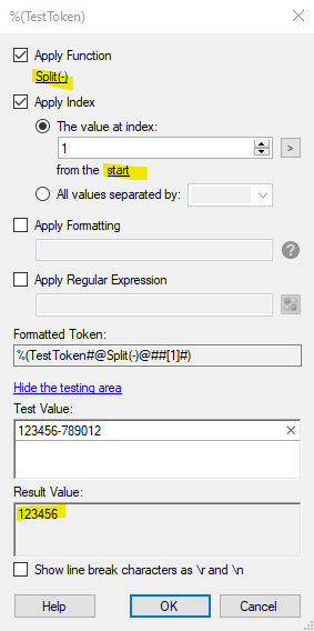

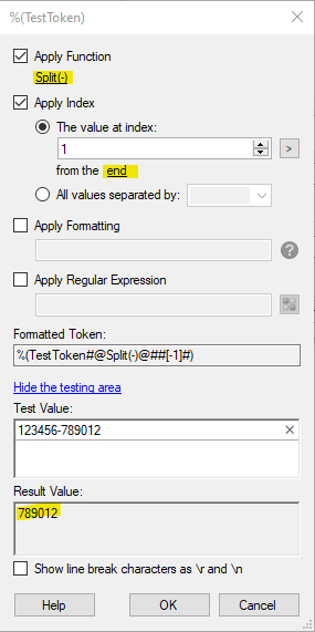

If you're guaranteed to always have the same format, another option would be to use the Token Editor.
Assuming your two values are always separated by a dash, you could use the token editor's Split function to split on the dash character.
Then you can use the indexing option take the first index for the invoice number and last index for the job number.
