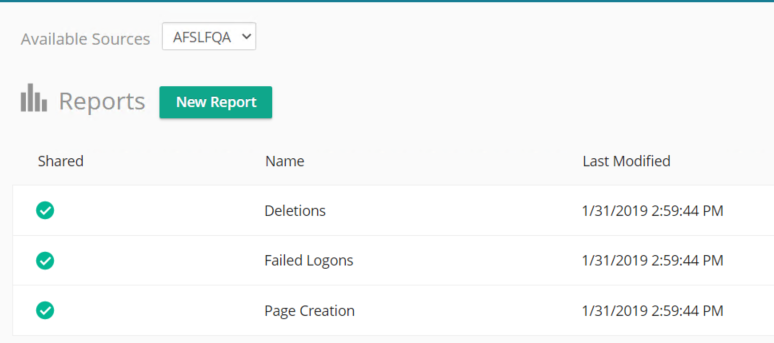

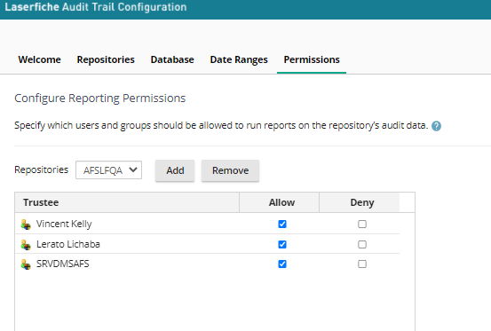

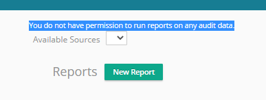

We are having a issue with only certain users, whereby Audit Trail gives the error "You do not have permission to run reports on any audit data." , only when accessing Audit Trail from any browser outside of the Server hosting Audit Trail. When the same connects to the Server directly via Remote Desk Top connection and then launch Audit Trail in the Browser, then it works fine. So the User has been granted permission to pull reports.
Permission is granted:
Error received outside on any client machine:
When the same User logs onto a browser directly on the server:

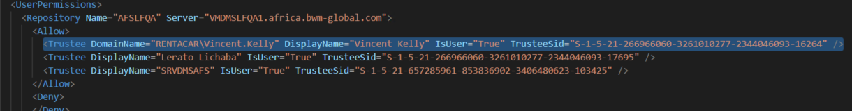

I've seen a post that stipulated that one should manually add the user into the config.xml file, which when I checked there was an entry already for the user, but I added the "DomainName" attribute as well.

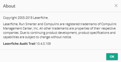

This is on 10.4

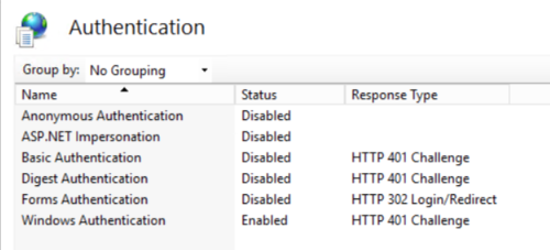

It kind of sounds like the users aren't correctly being authenticated. Are they prompted for credentials when they visit the site? You might experiment with using the plain hostname or the fqdn. You could also check in IIS manager on the application to make sure that Windows authentication is enabled and anonymous access is disabled (this is on the reporter application, under Authentication).

Hi Brian,
Thank you for the reply. I re-checked IIS, and can confirm that Windows Authentication is the only one Enabled for AuditTrail.
