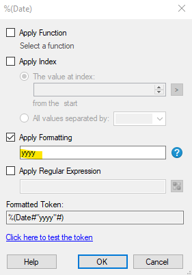

EDIT: Reading the post again it seems I may have misunderstood. I assumed you were talking about Forms, but are you doing this in a fillable PDF or something through workflow? If so, then you could just use the Token Editor (right-click, token editor) and date formatting like so,

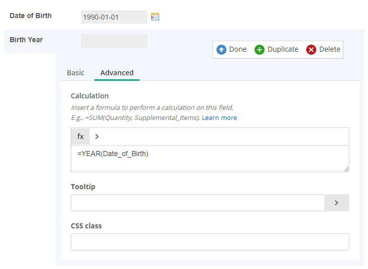

Instead of relying on regular expressions or anything, I'd add 2 fields, one Date field to store the full date of birth pulled from the lookup, and one Number or Single Line to hold the year (depending on how you may need to use the value).
If you use a Number, be sure to uncheck the box for comma-separated thousands and that the decimal length is set to zero.
Use field rules to hide the date of birth field and set it it to read only, then in your "birth year" field, use a function to extract the year from the hidden date of birth field.

Thank you, sorry my question wasn't clear enough but yes the workflow answer worked great!

Hello, I am trying to follow the same solution for a form using the "Year(Date)" method in a form as show in the screenshots below:
But for some reason I am not getting any results when I preview the form. The Project Start Year field always remains empty.
Am I doing something incorrectly?
replied on March 17
Hi Krishna,
Based on the circular reference warning, it looks like you're putting the calculation in the Start Date field, but it should be in the Project Start Year field.
replied on March 17 Show version history
Hi Jason,
Thank you for helping me. I was able to resolve this concern.
