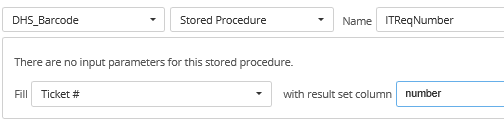

I have seen the many posts and followed the recommendations and admin help instructions to use a sequence and stored procedure to assign sequential numbering to LF Forms. All of it works except the resulting number is not showing up in the assigned field. I have used both the number and bigint as the result set column and neither works. I do know that my stored procedure is working b/c the number is incrementing. The ticket # field itself is defined as Number. Please advise and thanks in advance.
The lookup rule:

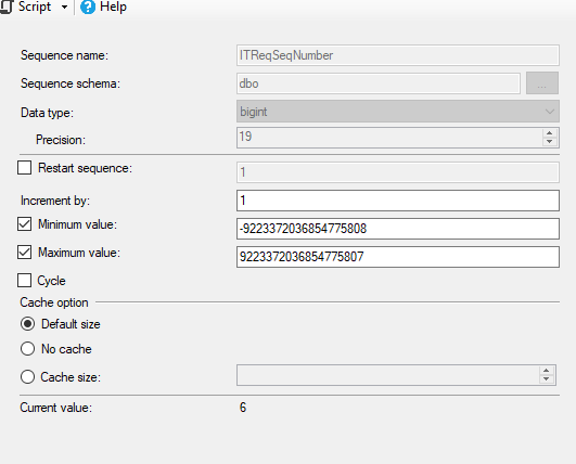

The properties of the sequence:

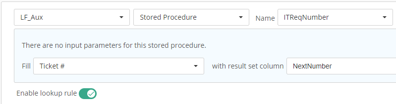

Then in your Lookup rule, use the new column name to populate the field
replied on September 13, 2021
Thanks!! It worked. My experience with SQL is limited. Take care.
