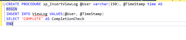

On a very basic level, without getting into API stuff, you could create a simple stored procedure that inserts a row into a database.

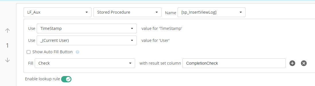

Set this as a lookup rule on the forms side like so, and you get a log whenever someone opens the form.
The slightly difficult part becomes knowing who has opened the form. In an internal process, you could just use their username, but on a public form, I believe it would always be anonymous. If you are sending out these links with unique variables, you could use that as a basis for Identification.
I would add things to the stored procedure such as checking if a row already exists, in order to eliminate duplicate rows, and adding things to the table like an instance number, or a semester/year combo, if we are using the course list example.
