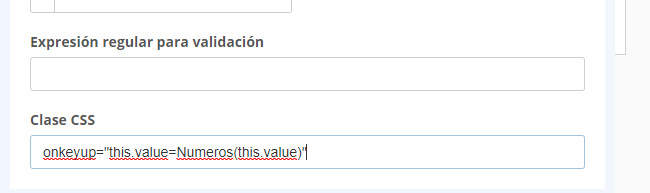

Hi guys.
Do you know how to put an event attribute on a Forms input field?
I´m doing like this, but it does not work.

replied on September 7, 2021
That field is only for adding a custom CSS class to the input element; there is no out-of-the-box way to add event attributes.
If you want to add a custom event handler, you need to do it with code in the JavaScript tab like what James describes in his post.
