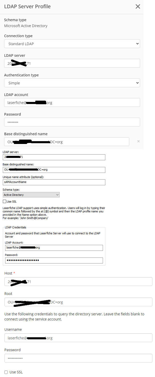

Yes, everything is the same. Both Admin Console and Forms running on the same OS tell me that my password is correct, only DS tells me it is incorrect. One of the apps must be wrong and it's 2 to 1 against DS. It must be a false error.
The screenshots below start with Forms, then Admin Console, then DS. The configurations have been copied exactly.

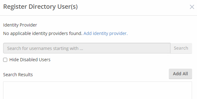

Please try sAMAccountName format when setting it up in LFDS (DOMAIN\Username instead of Username@DOMAIN.org)
replied on August 16, 2021 • Show version history
If I use domain\username without the .org the error changes from invalid credentials to no applicable identity providers found.
