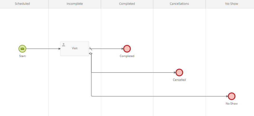

We have had the ability to setup stages in the forms process designer for awhile now and I often use this. Today I setup my stages in a cloud process, and I have clicked through all the forms reports in cloud and I do not see any which utilized the stages.
I am just looking for counts of how many submissions are at each stage of the process.

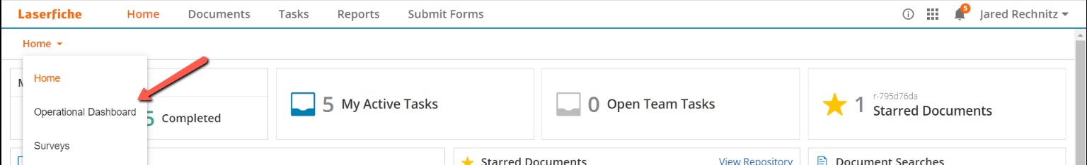

They should be in the recently released operational dashboard on the home page. Go to the main Home tab of LF home, then click on the dashboard dropdown. You will see Operational Dashboard where you can then pick which process to look at. That dashboard has an instances section that shows how many instances are in each stage.

You're on the Reports tab. We added the operational dashboard here under home in the beginnings of a dashboards area.

I am not having much luck there. I need a report to give counts for each stage I have defined at the top of my process diagram. So for example how many are in Incomplete, Completed, Cancellations, No Show. For both currently running instances and complete instances. For complete instance either the stage they completed in would work or I could use the end event name.

There is a table report under Process Automation, but it doesn't allow access to the stages or the end event names. No way to report on counts of the final status of my instances or see any aggregate data on what decisions were made (IE: Completed, Cancelled, No Show)
