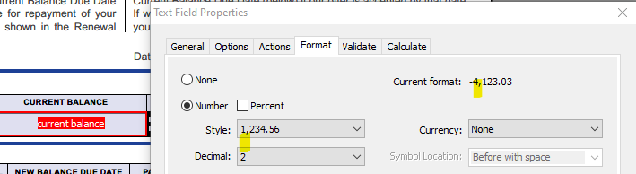

We have tested the PDF and the PDF field DOES insert the thousands delimiting comma into a number which is typed or pasted into the field, however, when Workflow writes the value into the fillable PDF field, the comma does NOT occur.
What is different when Workflow writes a value compared to when I just type into the field that stops the PDF from inserting the comma?

PDFs can be so complex and run tons of different validation scripts/javascript/formatters just like HTML. It is likely this particular formatter is not ran when inserting the value via code. My recommendation would be to just add it at time of workflow. Use token formatters for this.

@████████ thanks Jason, we observed the PDF fillable field format "number" with style: 1,234.56 does add the comma for thousands when we pasted or typed digits without the comma...
... so an assumption was made ( I know ) that the PDF field would also generate its own comma when LFWorkflow wrote the value.
going forward, we will use token magic in LFWorkflow to force the value to contain the comma before it arrives at the PDF.
