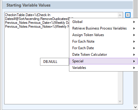

You need to use two Set Business Process variable tasks.
On the first one, you select EVERY variable in the table, and set each value to null. (Missing a variable will cause it to keep the previous number of rows). This can be done by selecting the token selector, then under the special category you use DB.Null.
The second Set Business Process variables will be unchanged from how you currently have it.

I have the same issue. I did try this approach and having 2 "set business process variables" does not seem to be an issue, however the table is still not cleared, and the old lines still appear in the form.
I also tried using DB.NULL to clear the table in one workflow, then use another one to populate it again. This does work to clear the data in the table but if the new table has less rows they will still be displayed but with an empty value - if I take the initial example, there will still be 5 rows displayed, however the last 2 will have no data.
Any suggestions to make this work properly please ?
