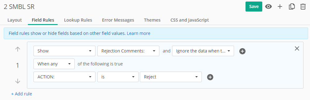

I've set up a field rule to show Rejection Comments when action is reject:

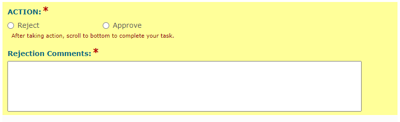

However, when the form loads, it still shows the Rejection Comments even though both of my radio buttons are not selected.
When I select Approve, RJ disappears. When I selection Reject, RJ stays there (or reappears if I chose Approve first).

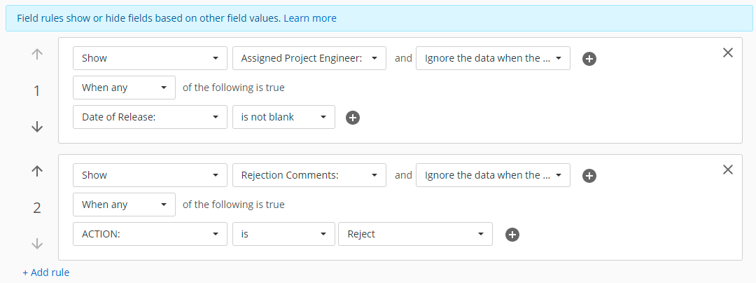

replied on July 28, 2021 • Show version history
You most likely have another rule lower down that's causing it to show on form load (field rules are run top down). The later rule is causing it to show initially, but triggering rule 1 would then get it working after the fact. The other rule is probably something like
Hide Rejection Comments if (condition that isn't met)
See if you have other rules targeting this field.
I only have one rule. This is it. I've never had this happen before. I have the same rule set on other forms, and those are working just fine.

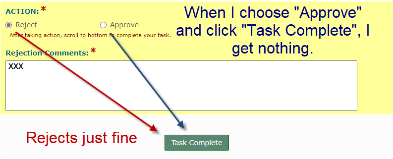

Works great, but now I have a new issue. Rejections work great! But when I try to Approve, my "Task Complete" button does nothing.

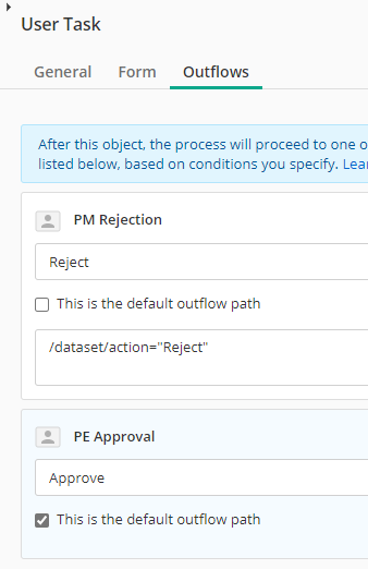

I'm close! In case you wanted to see my Outflows:
