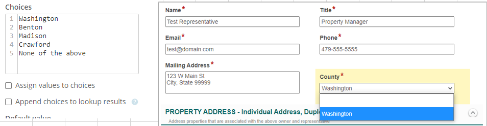

I have a drop down field on a form that is set with a list of values.  It is being populated by a lookup, however, I'd like the submitter to be able to change to another value in the list.
When the the "Append choices to lookup results" is not set, I get the value from the lookup, but not the other list values.

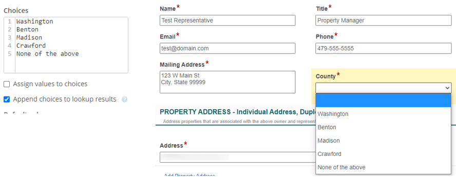

And when the "Append choices to lookup results" is set, I do not get the value from the lookup, but do get the list values.

You can't really use a lookup to "set" the value of a dropdown like you do with other field types, that will only set the "list" of values.
When there is only one result value, it is essentially the same since it auto-selects the only value available, but what it is really doing is populating the list of options not setting a specific value.
I imagine the reason it doesn't look like your Append selection is doing anything is because I believe there is some built in functionality to prevent duplicate options.
If you want to preserve the list and auto-select a value in a dropdown using the results of a lookup, then you'll need to utilize a separate hidden field.
Basically, create a hidden single line field that receives the lookup result value, then add JavaScript that will "transfer" that value to your dropdown whenever it changes.
