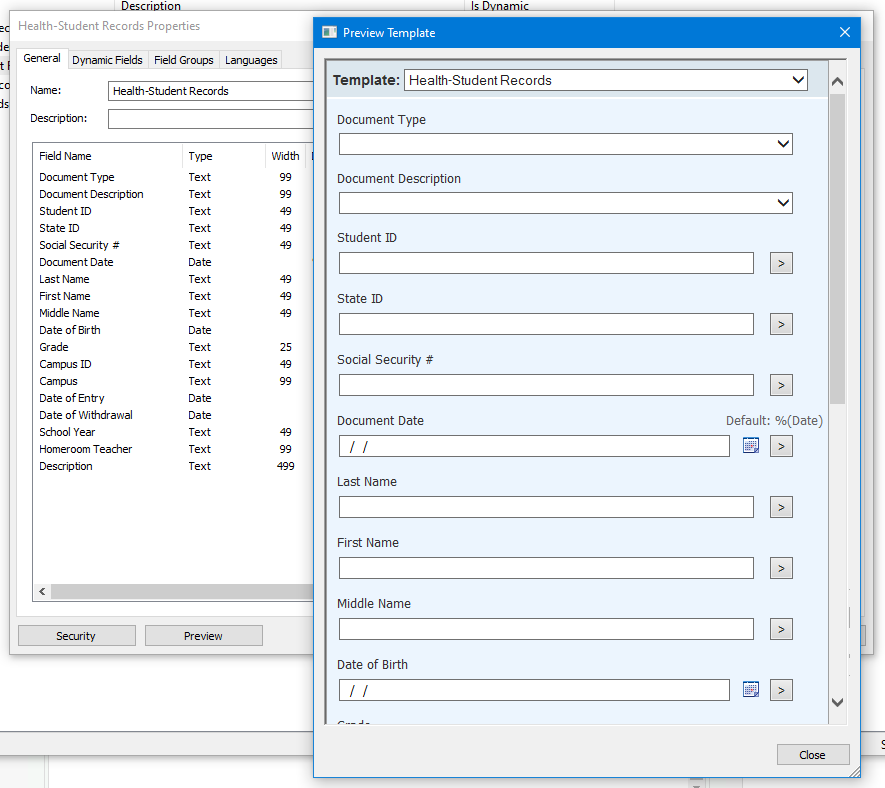

Here is what the template looks like.
Just to reiterate the document is not getting assigned the template at all before it's assigning the fields. My understanding is that the template needs to be assigned before any fields are, is that wrong?
replied on July 20, 2021
You must resolve the error before a document can be created, and you must have a document before you can assign a template.
There is a tab called Variables which will allow you to see the value of all your variables. Check the value of the variable you have set for Date of Birth. It says that it is not a valid value, so it is likely not a date.
replied on July 21, 2021
Yeah... I'm apparently blind in one eye and can't see out of the other.
The form was assigning a 6 digit number to the date of birth field, I hadn't set this form up.
Thanks for being patient, didn't know forms checked the fields before it assigned the data, was thinking it was in a different order.
