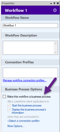

It sounds like you may have made the workflow a Business Process, a type of enhanced workflow, without intending or needing to. Try unchecking "Make this workflow a business process", republish the workflow, and retry.
If you did intend the workflow to be a Business Process, I think you need to add a Business Process Step activity:
Hope that helps.
