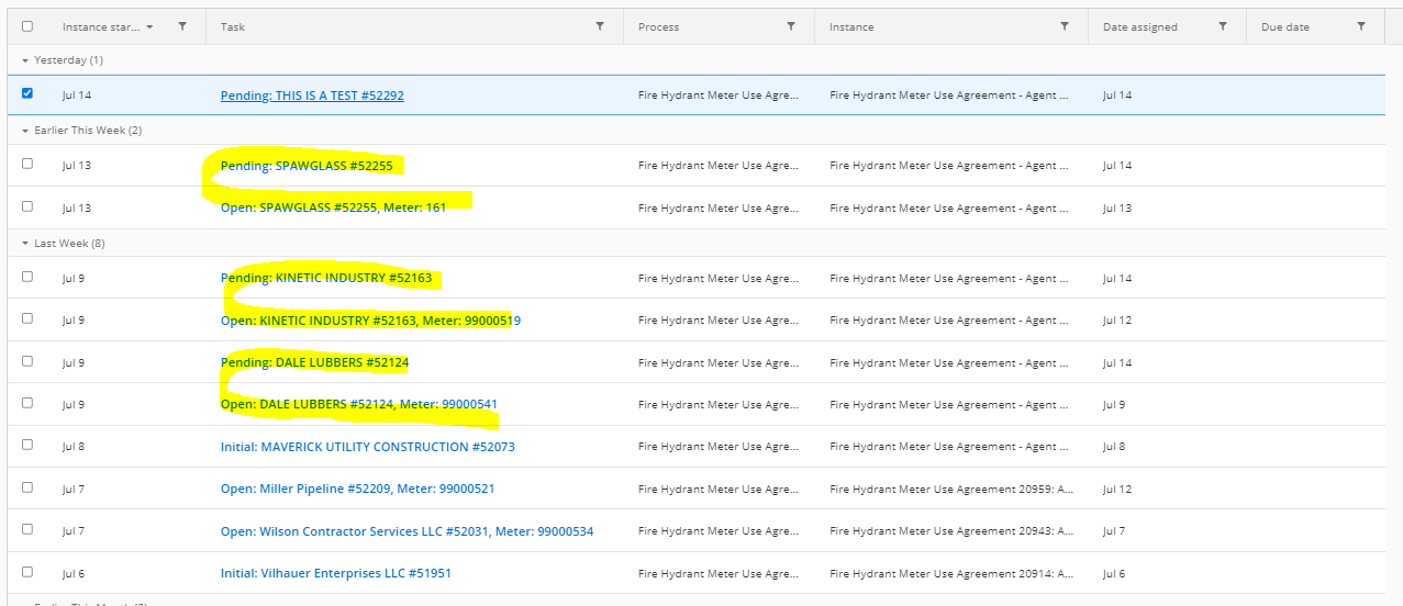

I am VERY new to Laserfiche and have just enough understanding to be very dangerous.  I thought I checked the process for errors after making an update, but clearly DID NOT.  My process has the following processes:
1) Initial
2) Pending
3) Open
However, I was asked to allow some instances to bypass the Pending status based on a specific business scenario.  I added the process, but had the email and save tasks set to save from the "pending" stage form which did not exist in these cases.  The result was many suspended processes.

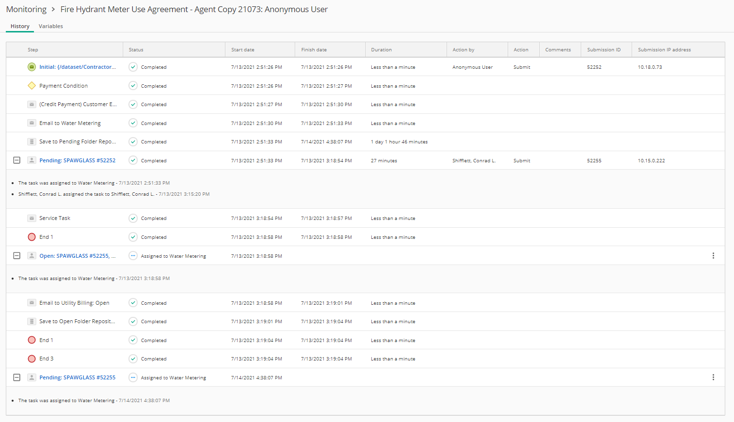

I corrected the error and all the processes went through.  It kept the Open task, but also created a Pending task in addition.
How do i resolve the pending task without affecting the open one?

If you are on Forms 10.4.2 or later version, you can try to Interrupt the Pending task if the step and following steps are no longer needed.
See online help for more explanation https://doc.laserfiche.com/laserfiche.documentation/11/administration/en-us/Default.htm#../Subsystems/Forms/Content/Monitoring-Process-Instances.htm
replied on July 16, 2021
I just want to confirm that if I interrupt the Pending task it will not impact the ability of the additional Open task to be worked.  Correct?
replied on July 18, 2021
Interrupt stops processing of the branch at that point, as if the step was a End step.
Yes, interrupting the Pending task should not impact the Open task and following steps as long as those steps don't rely on Pending task.
If you feel uncertain, you can setup a test process to try the functionality.
