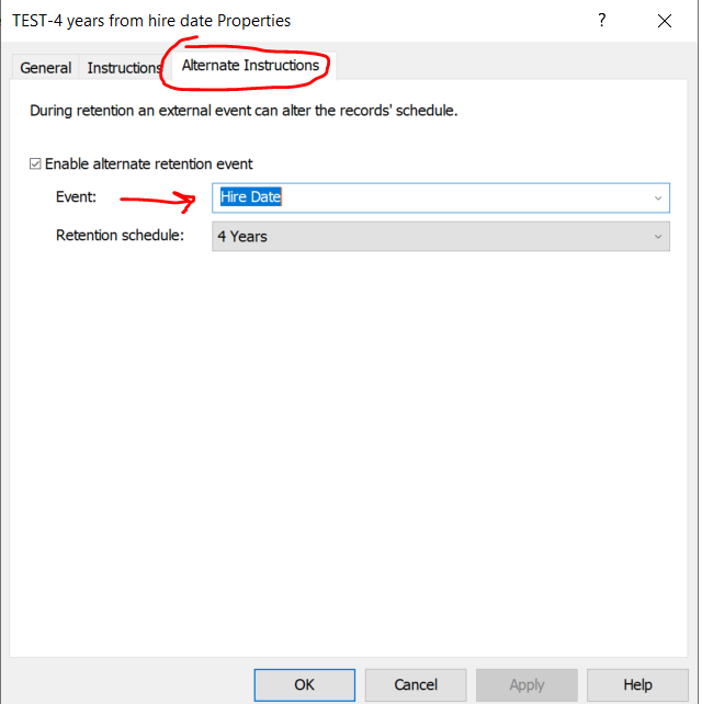

replied on June 21, 2022
Hi Justin, I am trying to use the "alternate instructions" option to set a retention period. Everything seems like it would work great, IF I could tie an Event to a metadata field. For example, I am trying to delete record after X years from a specific event/date that is filled out in the template in a metadata field. I'm hoping to come up with a relatively simple solution since this will need to be put in place for several folders with similar but different retention periods.
Thank you for any help yon can provide.
Justin or anyone else have a simple solution to this issue? Thanks much.
replied on June 22, 2022
I am not sure what your original RME Schedule is, but the way to accomplish this is by setting your original RME schedule to be 4 years after hire date and then setting the RME properties by a workflow. Workflow can grab the date from the metadata and set the RME hire date to this date. Workflows can be started based on entries changing with specific criteria.
This however only works for traditional RME cutoff and retention instructions, and unless something has been updated, does not work to set alternative instructions. If hire date needs to be an alternate instruction, it would need to be set manually.
