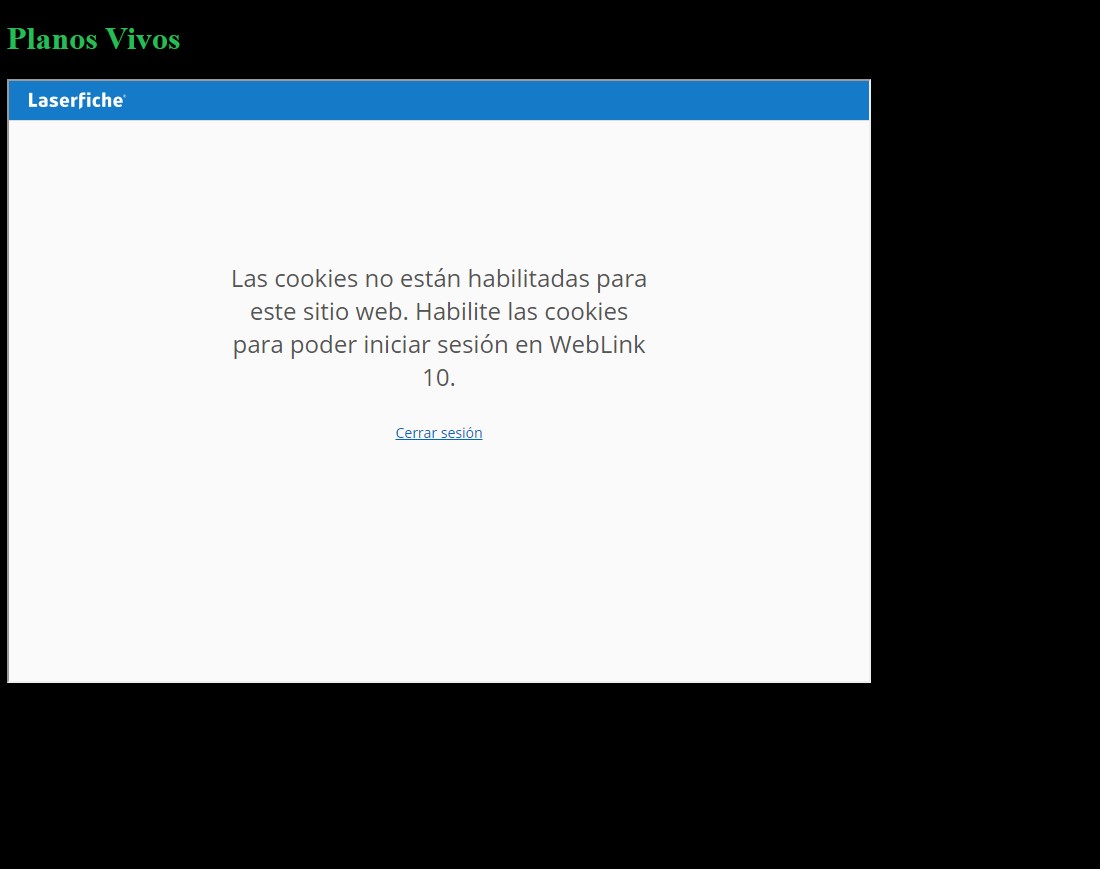

We need embed Laserfiche Weblink in a website, when we try do it, weblink shows the follow message:

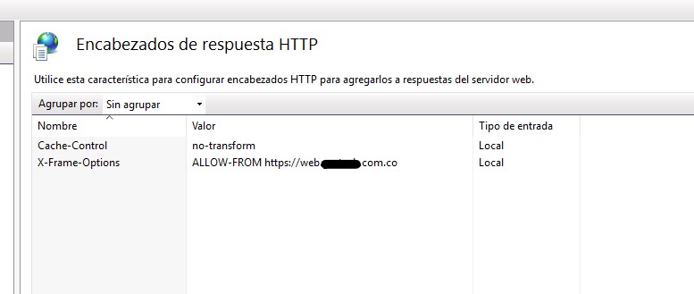

in iis-site we have the follow headers:

Remove the x-frame option and see if it works better,
I get a similar issue but my message was "refuse to connect" and when I remove the X-Frame entry from the HTTP Response Headers, that has fixed my issue

Hi Rene, Thanks for your help...
We tried it but the issue persist, then we tried removing the Cache-Control as well but we got the same result.

Are both sites using https and on the same domain? Have you applied the changes discussed in https://support.laserfiche.com/kb/1014094/additional-configuration-for-chrome-80 ?
